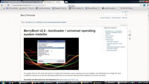

Step 1: Berryboot
1. Get Berryboot.  Berryboot will allow you to download several Raspberry Pi images.

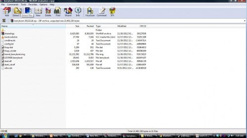

Step 2: SD Card Preperation
Now extract the zip files to a blank SD card.

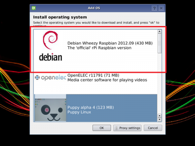

Step 3: Berryboot
Put the BerryBoot SD card in your Pi and boot it up.
2. Setup RPi with Raspbian Wheezy (first option).

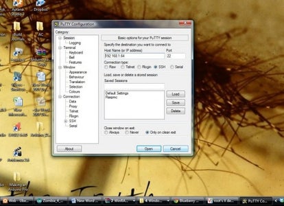

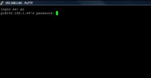

4. Setup PuTTY on your Desktop Computer.  Follow this video. This will allow you to begin SSHing into the Pi.  That way you don't have to look at a little RCA screen like me.  For those who aren't familiar with SSH (like I was before this video), the video will explain it.  At risk of oversimplification, it allows you to access your Raspberry Pi command line through your desktop.
You have to plug in your Pi's network number.  You can find this by pulling up your wireless hub's configuration page.  You should see what address your Pi is listed at.  For some strange reason, if it doesn't list the device name, just view the page while the Pi is up, then unplug your Pi and refresh the wireless hub configuration page.  The device that disappeared is your Pi.  I've never had to change the port number, but beware you might need to depending on your setup.
Step 6: SSH

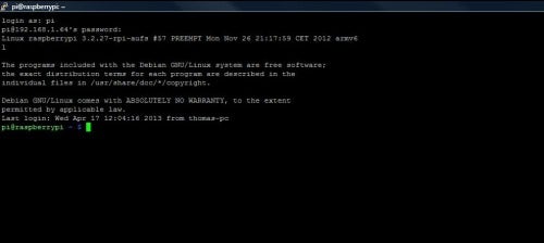

If you want to know whether your have the correct information, try login' in and if you get a screen like this, your good.
Your username and password are by default: pi, raspberry
Remember! In the case of a Raspberry Pi, always share your password, 'cause everyone has it anyway :)
Step 7: SSH
Once you have PuTTY setup, you should be able to bring up your Pi command line, something like this:

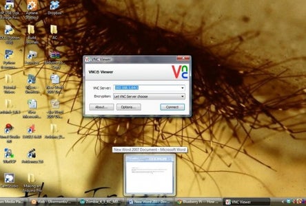

5. Setup VNCServer on your Raspberry Pi.  Follow this video. (Or this walkthrough). Putty will let you access your Pi's command line, but setting up a VNC will actually allow you to access your Pi's Desktop GUI from your PC, in the same manner as Putty.
6. Setup a VNC Client on your Desktop Computer. Real VNC.  There are many different programs, I happened to end up using Real VNC.

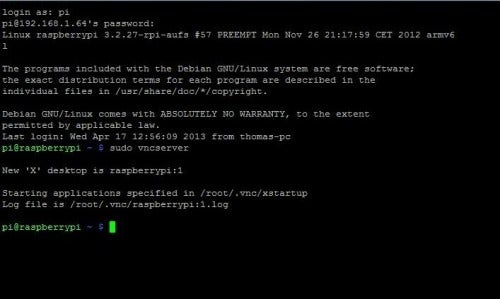

Once you have VNC setup on both machines, PuTTY into your Pi and start the VNC server.
$sudo vncserver

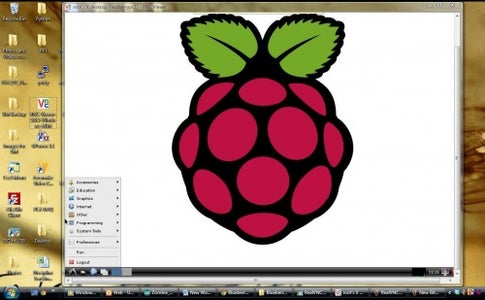

Two notes here, if you did better with the video instructions than I did, your vncserver will start automatically on boot.  Unfortunately, I have to type it each time (I'm too lazy to figure out the boot part of it).  As a result, you'll have problems running certain Python scripts through VNC if you don't use $sudo vncserver
You should end up with at a windowed version of your Raspberry Pi desktop.  One more note, somewhere in the video it gets you to setup the "geometry" of the VNC desktop.  The limitations you put there will be reflected in the quality of the desktop you see in the window.  In essence, if you put in 640x480, that's the resolution this desktop will end up.  So, please, take advantage of the Pi's GPU :)
Use something like this, "-geometry 1024x728 -depth 24"

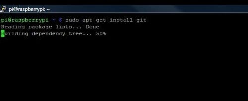

Step 11: GIT
8. Git manager will allow you to pull code from git hubs (again, this should already be installed, but just in case).
Install the git manager:
At Raspberry Pi prompt:  $sudo apt-get install  git
The way to use it is like so,
At Raspberry Pi prompt:  $sudo git clone https://github.com/adafruit/Adafruit-Raspberry-Pi-Python-Code.git

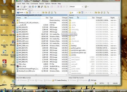

Step 15: WinSCP
12. Install WinSCP.  This will allow you to transfer files between your desktop and the Pi.  I find this helps with programming management.  I'm a messy filer.  If I file at all.

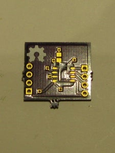

Step 16: Make an I2c Optoisolator
13.  Take a deep breath.
14.  Follow these instructions for making my I2C optoisolator board.
Step 17: I2c Between Pi and Arduino
Again, there are many commercial boards that will serve the same function.  Also, you can do the same with a USB cable, serial pins to GPIO, or RF connection--basically any way that lets the Arduino and Pi talk at a reasonable speed.  The speed restraint will of course depend on your need.  I doubt many methods will be apt for running a responsive quadrocopter.  But in my case, my Pi is the central nervous system and the Arduino is the autonomous nervous system.   The Pi will send directives, but it's up to the Arduino to manifest them through responsive actuators.  And I chose this optoisolator because I didn't want an voltage restraint on my actuators or fear of frying my Pi.

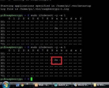

Once you have the board setup, you can run:
$sudo i2cdetect -y -a 1
This should bring up a list of active I2C registers.  You should find your Arduino at whatever address you set in your Arduino code.
