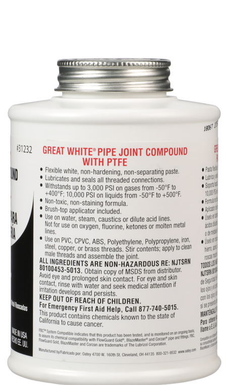

    Don't use PTFE pipe dope with natural gas & propane.

    It's rated for natural gas and propane. A gas fitter told me to use it.

    Well, I was using a ca. 20 yo can of Oatey Great White w/PTFE that said it could be used for natural gas. An HVAC guy who installs furnaces, etc., told me no on PTFE dope. Interestingly, Oatey no longer recommends that for natural gas...
    Per Oatey:
    Q. What pipe joint compounds are recommended for use in an approved piping system filled with Liquefied Petroleum?
    A. The following Oatey pipe joint compound products are approved for use in this application: Oatey Great Blue, Hercules Block, Hercules Megaloc, Hercules Grrip and Hercules Real Tuff.
    Q. For natural gas?
    A. To the above list add Hercules Pipe Joint Compound and Hercules Pro Dope.
    (https://oateyassetscdn.azureedge.net/assets/Document/raw_FAQs_Category2.pdf )
    Anyway, it's dicey at best what is permitted in what location but clearly the Great White w/PTFE on NG fittings has fallen out of favor with the manufacturer.
