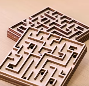

When the laser cutting ball-in maze toy is completed, it’s time to get it out! No special treatment required, just take it out and lightly wipe the dust off the surface. After that it’s just a matter of gluing the layers of ball-in maze toy.
Cutting basswood boards can produce a lot of grease stains, especially in mass production. To maintain the laser engraver, it’s important to clean the lens and the autofocus sensor after using.
applying glue to layers of maze toy
Come and Try!
Imagine children building focus and dexterity as they guide a tiny ball through the twists and turns of a laser cutting maze, its pathway precisely crafted to challenge and delight. The ball-in-maze toy isn’t just fun; it’s also a captivating way to develop problem-solving skills, patience, and hand-eye coordination through play.
Perfect for curious minds of all ages, laser cutting makes it easy to create mazes in a variety of shapes and difficulty levels. Whether used at home, in classrooms, or as creative gifts, these interactive maze encourage learning through movement, bringing joy and discovery with every roll.
laser cutting ball in maze toy done
