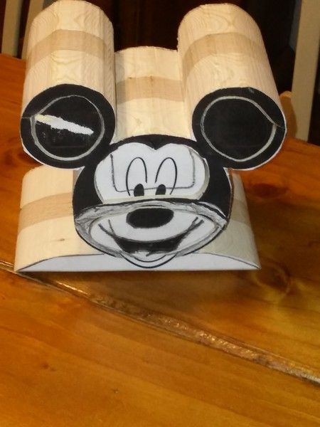

The next thing I had to do was cut out the shape my box would be. This can be whatever you want it to be. I started with a template of Mickey Mouse ears but had to scrap it because I messed up on Mickey’s ear. So I just went with a simple rounded top with a flat bottom. You can use a template and spray adhesive to glue it to the box or you can just draw the shape on the box. After you have your shape, you can start to cut it out on the bandsaw. A tip I have learned with cutting with the bandsaw is to just keep the piece moving along but don’t try to go too fast. Also, try to stay outside your line just a little bit. You can sand it later on but it is better to have extra space to work with then cutting too much off. (Like I did with Mickey’s ears) After your shape is cut out, you will need to cut about half of an inch off the back of your box. You will glue this back on later. (Watch my video to understand this fully.) Once the back is cut off you can cut out the drawer.
