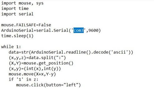

Step 4: Changing the Com Port in the Python Program
Paste this program in a Notepad -
import mouse, sys
import time
import serial
mouse.FAILSAFE=False
ArduinoSerial=serial.Serial('com3',9600)
time.sleep(1)
while 1:
  data=str(ArduinoSerial.readline().decode('ascii'))
  (x,y,z)=data.split(":")
  (X,Y)=mouse.get_position()
  (x,y)=(int(x),int(y))
  mouse.move(X+x,Y-y)
  if '1' in z:
   mouse.click(button="left")
Change the com3 part of the program to the specific port which is applicable to you. Save this file as Python.py in Notepad.
