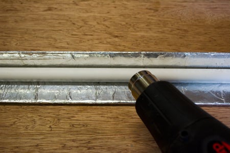

Place the pipe into the trough or onto a heat-resistant surface. Before you start heating the pipe, make a mark 4 inches from the end and another one inch away for the handle.
Begin heating the pipe on high. Keep the heat source moving and don't let it settle in one spot. Rotate the pipe after each pass and continue heating until the whole pipe is soft enough to be flattened all along its length with finger pressure. It is important that the pipe is hot enough, or it won't flatten properly.
Once the pipe is hot enough, move it with gloved or covered hands to a flat surface and press down with the flattening jig. If the board has a pronounced grain, it will leave an impression on the pipe. This can make for some very realistic faux wood. Try to avoid really rough or damaged boards with knots for the same reason.

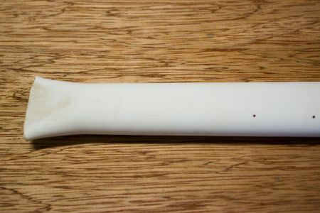

Heat about an inch of the end of the handle. Once it's pliable, press it under a board at an angle to pinch the end closed. Once filed down, this will make a nice and smooth end that will sit nicely against the palm.
Next heat up the one inch section between the two marks until it is soft enough to press. Two pieces of 1/2 inch scrap pipe make a good form to press the handle. It should be around 1/2 an inch wide between the grooves.
