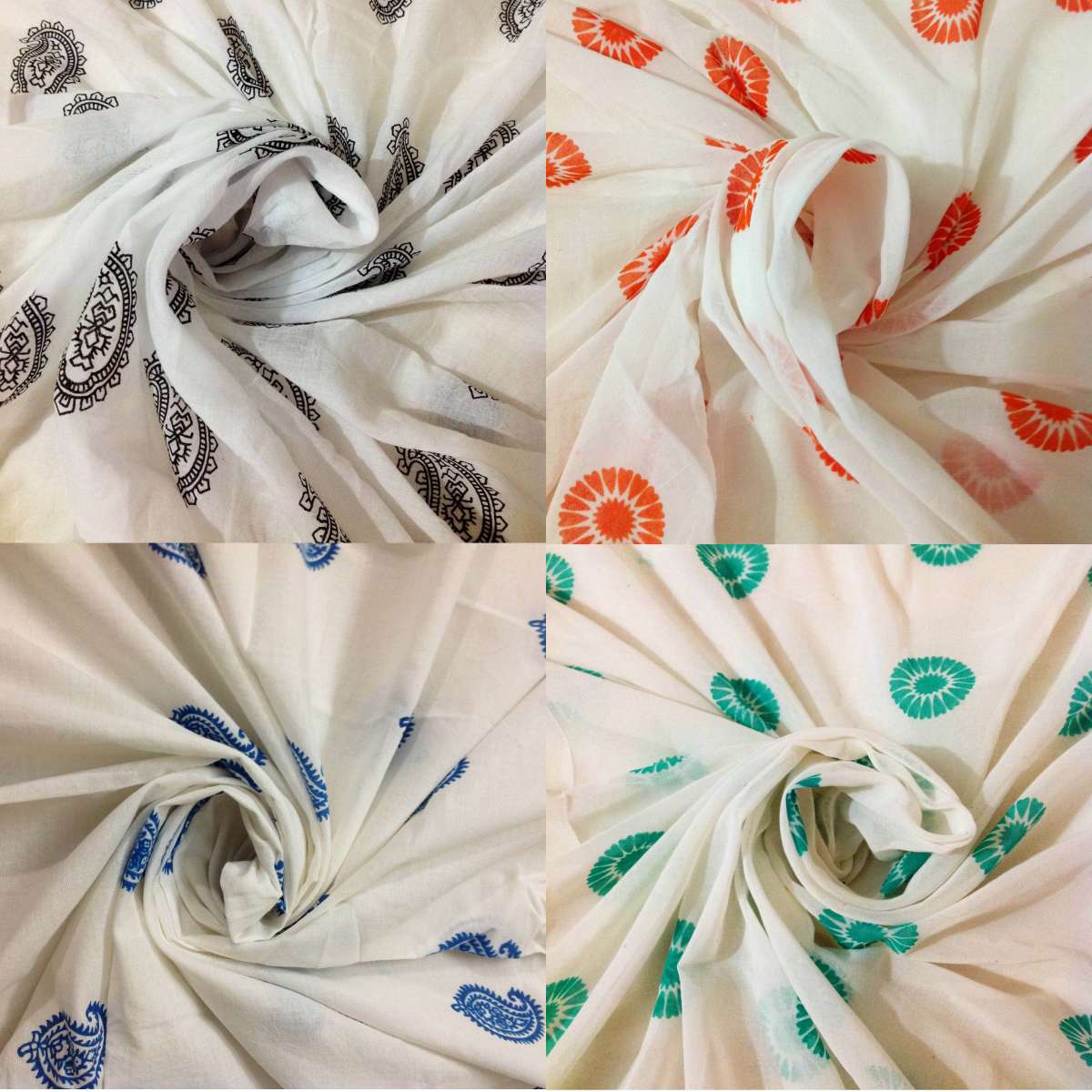

2. A thick cotton cloth in 14x14 inch size. A matching thin cloth for lining of the same size. 2 pieces of 14x17 inches size for making envelope style closing. ( I used an Organic muslin fabric with very high thread count)
