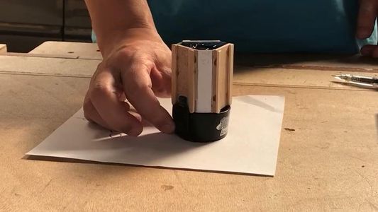

The shape of BL1013 is similar to a hexagon, so I designed an asymmetric hexagon to fit its shape.
The code is 32+12:
long side = 32mm.
short side = 12mm.
height = 53mm.

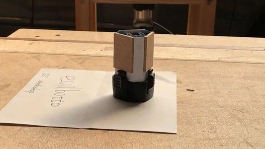

First, use thick cardboard to build the model.
There are three layers of shell.
The first layer is MDF. 32*53 (1), 32*42 (2)
Layer 2 is popsicle sticks. 6.5*53 (6)
Layer 3 is also MDF. 32*48 (2) , 32*53 (1)
*(n) is quantity.

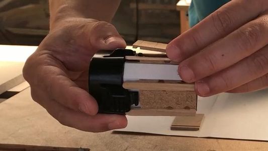

The vital function firmly fixes the battery when it inserts into the shell.
I must make a suitable groove to match the latches on the battery.
The groove is inside the 3rd layer of the shell.
I have tried drilling and digging holes, and finally, I think it is the best way to cut it with a saw table, and the depth is about 1.2~1.5mm.
I used some balsa wood for the short side shell.

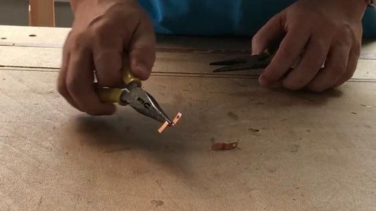

2 pieces of copper. thickness = 0.5mm, width = 4.5mm, length = 25mm.
Reluctant to throw away the pure copper radiator, I didn't know what to do before, now I know.
Drilling and tapping M3 to lock the screws.

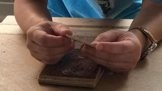

Bend into a Z shape.
Insert the coppers

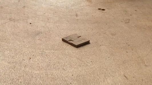

Make a 24x24 small board to fix the copper sheet.
Use a multimeter or voltmeter to test whether there is power.
When there is no problem, stick them together.
