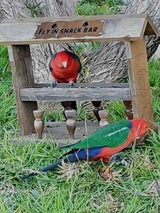

I am not a big fan of birds, but my sister loves them. On a daily basis, she has loads of king parrots that come to her house for feeding. She has been feeding them for so many years now they will even eat out of her hands. Here in Australia, we have so many birds in our garden on a daily basis it seems only kind to feed them. This bird feeder was made from mainly pallet wood and scraps.

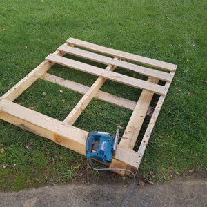

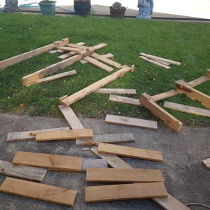

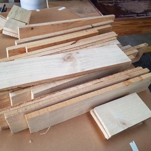

Step 1: Cut Up a Pallet
For this project, I used pallet wood but you can use any suitable wood. Because pallets are made to sit outside in the weather they are perfect for this project. Start but cutting the wood from the pallet, a jigsaw works great for this. Cut all the wood between the supports. I have tried in the past to take a pallet apart which proved really difficult for me.
Step 2: Sand the Wood
Using whatever sander you have, remove all the rough edges from the pallet wood. This is to prevent hurting the birds when they are eating. To remove all the damaged edges from the wood you can use a table saw to trim about 50 mm of each side.

This is where my project came unstuck, I gave no thought as to how I was going to attach the roof. And unfortunately, my side supports were too short. Once the roof was fitted, there was not enough gap for the birds to get to the food. This is what happens when you make up projects as you go along. Using another scrap of pallet wood I extended the side supports and cut it to the angle of the roof. To join the extension to the sides, you guessed it, I used the pocket hole jig.

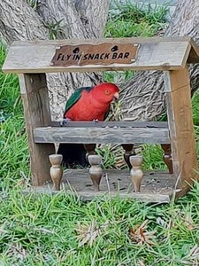

Step 11: Attach the Roof
The roof was then glued onto the side supports and secured using a nail gun. You can screw them in if you don’t mind seeing the screw heads. Using a very technical method, the roof was weighted down while the glue was drying.

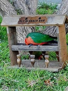

Step 12: Adding the Signs
Just for a bit of fun, I added a sign to both sides of the roof. To make the signs I used scrap MDF and cut two shapes freehand using a jigsaw. Using the homemade wood stain I stained the wood and sealed it with an exterior varnish.
Step 13: Adding the Text
I don’t have nice handwriting so I made some vinyl decals using permanent vinyl and a Cricut vinyl cutter.
Step 14: Attaching the Signs
You can use a silicone adhesive to attach the signs, I also added studs for a decorative look. Apart from the mess up with the side supports, I love how the bird feeder turned out. And I think the king parrots would agree.

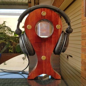

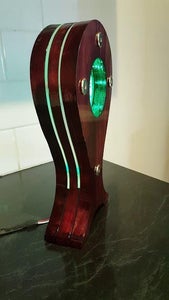

Step 16: LED Headphone Stand
This LED headphone stand was cut and made by hand. It is a great way to store your expensive gaming headphones when not in use.
