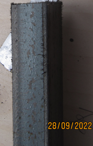

Step 1: Cut Your Angle Steel
Get your angle grinder and cut your angle steel to the length, height, and width you want
Step 2: Sand Any Burs Off
Get your sanding weapon of choice and attack those burs giving the putter nice smooth edges on the steel
