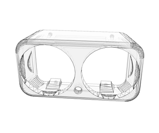

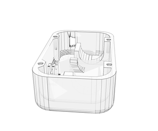

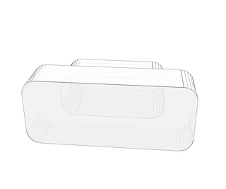

Step 2: Print the Case
The speaker consist three parts. Print the part "base", "middle ring", "top" and "button". The CAD files are attached. Print the "base" part first so you can install eletronic parts while waiting the second part to be printed. It would take about 4 hours to print all parts.
Step 3: Soldering the Battery
There's a 18650 lithium battery installed to power the system. Distinguish the positive and negative ports of the battery. Solder them to 'BAT+' and 'BAT-' ports of the charging module. You can charge the battery to check if it's soldered appropriate. Then install the battery and charging module into the 3d printed case. You can use some hot glue to fix them in position.

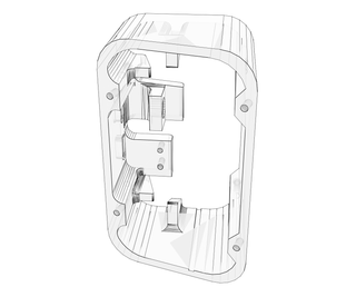

Print and prepare "middle" and "button" parts before this step. Solder the positive electrode of battery to one port of the twist switch. Then connect the output of twist switch to the Power port of the bluetooth module. Connect the GND port too. Solder 2 more wires from the Power and GND port for the amplifier module. Install the twist switch into the middle part. After that, Install the micro switch and button, solder them to the boot contacts of the bluetooth module. Fix the base and middle parts with 4*2mm pins (you can find holes on the shell).
Step 6: Install Power Amplifier and Speakers
You need to print and prepare the 'top' part before this step. Install 2 TDA2030 amplifier module in to the 'middle' part. You can find the support prepared for them, glue them with hot glue gun. Then connect the power wires, left and right channel signal wires to it. Remember to use some heat shrink tube to avoid short circuit. After that, glue two speaker into the 'top' part, solder them to the output of the amplifier. Don't forget the led, install it into the 'top' part. Power up and test the system before seal all parts.
