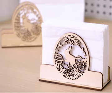

Let’s craft laser cutting wooden Easter napkin holders! Featuring delicate egg and bunny designs, this festive piece brings charm and elegance to your holiday table while adding a touch of handcrafted beauty.

When the laser cutting plywood is completed, it’s time to get it out. Then it’s just a fun assembly time to get the ideal wooden Easter napkin holder. Imagine the joy of assembling, as each piece clicks into place to create a wonderful Easter home decoration.
Come and Try!
Laser cutting on wooden Easter napkin holders adds a unique, festive touch while showcasing intricate craftsmanship and durability. Featuring charming egg and bunny designs, these holders are perfect for decorating your holiday table and enhancing seasonal celebrations. Laser cutting offers a stylish and creative way to bring Easter cheer to any setting!
laser cutting bunny napkin holders assemble
laser cutting bunny napkin holders use
