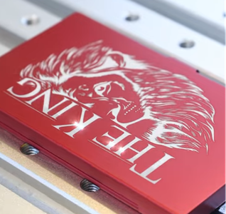

laser marking business card holder
Step 6: Complete the Laser Marking
Once laser marking is complete, carefully open the door and get your personalized business card holder. Laser marking does not produce toxic substances, and you can use the business card holder after a simple cleaning!
laser marking business card holder done
