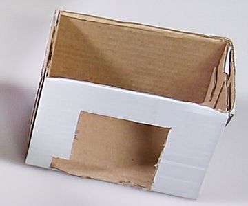

Three boxes are used here: one to be fixed to the Rollman to load goods, one to the sorting center, and another at the destination to receive goods. Their size should be about 10 x 7 x 7cm; avoid making them oversize or too small or they will be too large or heavy to carry, or too tiny to convey goods.
Take one box, cut out its roof and stick tight the card stocks on the sides. In its front, dig and cut a slot of 5x5cm, and then at the lower left corner (facing slot side) a more slot of 1x1cm, making the whole slot a square hole with a bulge.
It should be like the second picture.

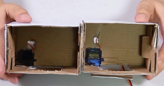

Place the servo on the bottom of the box, align the shaft with the slot, and fix it with glue. Cut the paper sheet (the roof of the box previously cut out) into a 6x5 one, insert the screw packaged with the servo through the sheet from the white side, fix it with the glue gun, put the round rocker arm onside, and insert the servo shaft into the rocker and fasten with screwdriver.
Step 4: Extend Servo Wires
Since Rollman is connected by the RJ11 port, connection with the servo needs adjustment. First carve and cut out another slot on the bottom of the box. Cut off the 3-pin socket of the servo wires and one end of an RJ11 cable. Note: There are 8 wires in the RJ11 cable and you need to connect some with the servo ones – green one to brown wire of the servo, blue one to the red, and black one to the yellow wire of the servo. And remember to wrap each connected wire with black tape in case of short circuit.

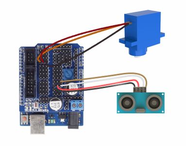

After the sorting center is built, connect the ultrasonic and servo to the Sensor Shield.
Wiring:
The orange wire of the servo to Pin 3 (signal) of the Sensor Shield, red wire to VCC, and brown one to GND.
GND of the ultrasonic to G, VCC to V, ECHO to Pin A0, and TRIG to Pin A1.

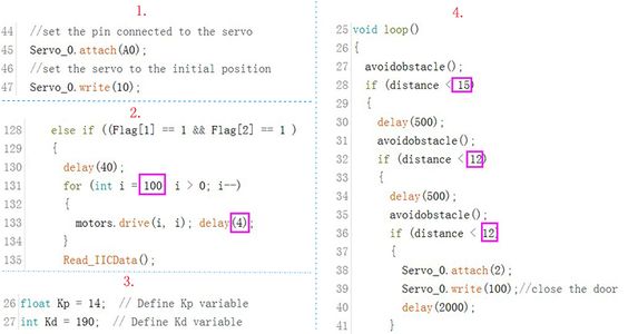

Step 11: Calibration
1. Calibrate the servos (change Cargo_Carrying_Car.ino and Sorting_center.ino)
In the initialization part in the code, the initial angle can be 0 or 10 degrees. Take down the door and place it at the position where stuff in the box are just about to fall down. Adjust the angle of the door and the box based on actual use. Use pins among pin A0-A5 based on the real conditions - accordingly change the pin in the code.
2. Calibrate the turning speed of the Rollman (modify Cargo_Carrying_Car.ino)
There are curving route and T-shaped crossing in ROLLMAN_DIY, which complies with the right-hand rule. The distance between the black chunk at the stop point and the route end should be 4-5cm; adjust it on the map if needed or modify the code instead (the delay time and the speed i).
3. Adjust the turning angle (change the code file Cargo_Carrying_Car.ino)
In the ROLLMAN_DIY route, if the programs for each are different, adjust the PID parameters so the Rollman turns according to the curves of the route. Adjust the P and D values in the program.
4. Adjust the distance to Rollman detected by the sorting center (Sorting_center.ino)
The sorting center needs to detect the distance to the Rollman via ultrasonic and control the opening and closing of the door. So it would be better to adjust the limit of the distance or move the center.
