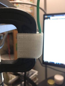

Step 7: Attach the 3D Printed Part
If you are using the 3D printed part, this is where you glue it onto the c-clamp.
Step 8: Attach the Wire
Insert the wire into the hole made in the 3D printed part and use glue to secure it in place. If you aren't using the 3D printed part, you can just zip tie the wire on and use super glue to glue the wire in place.

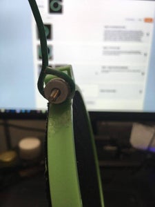

Step 9: Attach the Wire to the Embroidery Hoop
Loop the wire around the threaded rod and glue it securely into place. Try to not do what I did and make sure you don't glue the nut in place so you can disassemble the hoop and replace the cloth if necessary.
