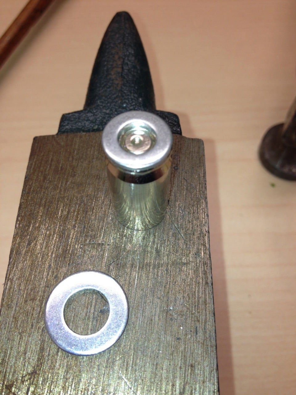

Step 2: Remove the Cap
You can remove the cap (the part that the firing pin compresses, causing the power to burn...rapidly), if you would like to have a clearance hole; by pressing a pin or other suitably slim item down the pin hole, you can clean the tobacco plugs from the cutter.
Stand off the cartridge from a hard flat surface by using a washer or machine nut which has a hole LARGER in diameter than the cap.
Find a very slim tool; a punch, a jewelers screwdriver, allen wrench, etc... Place it down the open end of the cartridge and into the little hole in the bottom.
Now, using a small hammer (or other suitable stand-in for one) tap the punch gently...the cap should pop right out.

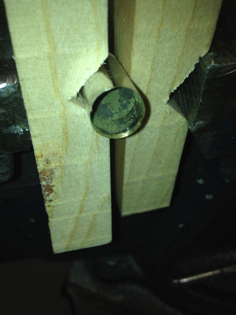

Step 3: Grind, Cut, Lap the Cutting Edge
Now, put the cartridge in a vice with SOFT jaws....it is very thin brass after all :-)
Using a suitable tool, sharpen the INSIDE EDGE (Interior diameter) of the cartridge very carefully. I used a dremel tool with a very fine lapping tool installed. A small rats tail file or even a sharp knife, will work really quite well.
