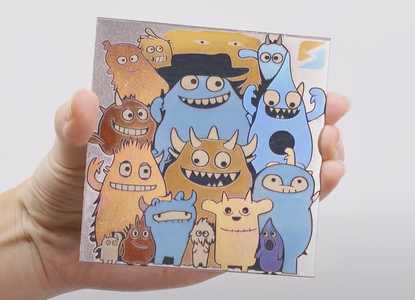

Color laser engraving brings monsters parade to life! Get ready to turn your titanium plate into a vibrant playground of quirky, colorful monsters with color laser engraving! Each design is permanently engraved with bold hues that shift under different lights, creating a dynamic and eye-catching effect.

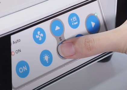

Missing the focus is one of the biggest reasons for color laser engraving failure. So don’t forget to click the AF button for auto focus.

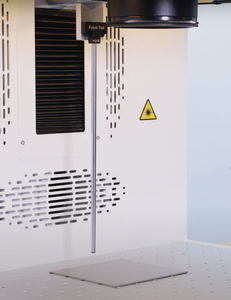

Of course, manual focus is also effective. Hang the focal stick at the correct position under the lens, and then carefully adjust the Z-axis height. When the end of the focal stick just touches the surface of the titanium plate, it is in focus!

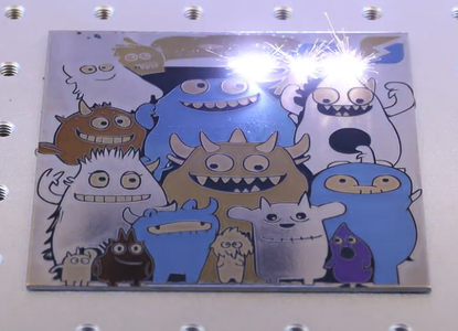

Step 4: Ready to Start Color Laser Engraving

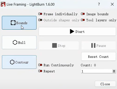

Press the frame button and check if the visual red light indicate the right area to be color laser engraved. The frame should be located in the middle of the titanium plate. If not, move the pattern positions until they align.
After checking, close the laser door and begin Aurora Lite’s operation.
Step 5: Monitor the Titanium Plate Color Laser Engraving
Stay near the laser machine throughout operation to monitor for any unusual sounds or alarms. This door ensures safety during processing, as the energy is potent. Avoid looking directly at the laser beam, even with protective measures in place.

The colors on the titanium plate are created through controlled heat application, with the color pattern shifting to reveal different shades when viewed from different angles or under varying light conditions, offering a dynamic and captivating experience.
A color laser engraving titanium plate is a blend of style, function, and personal expression. Whether for daily use or as a meaningful gift, its sleek design and lasting engraving make it truly special. With color laser engraving, you’re not just adding a design—you’re making it yours.
