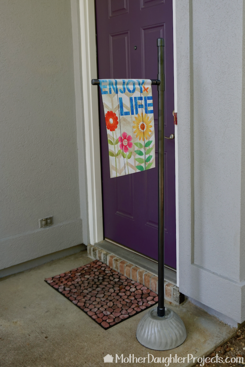

Step 5: Uses for the Base: Outdoor Flag Stand
With the base dry and upright, any one inch diameter metal pipe can be screwed in. For the garden flag stand, which you see above, we used PVC fittings. Please refer to that video to see it come together.

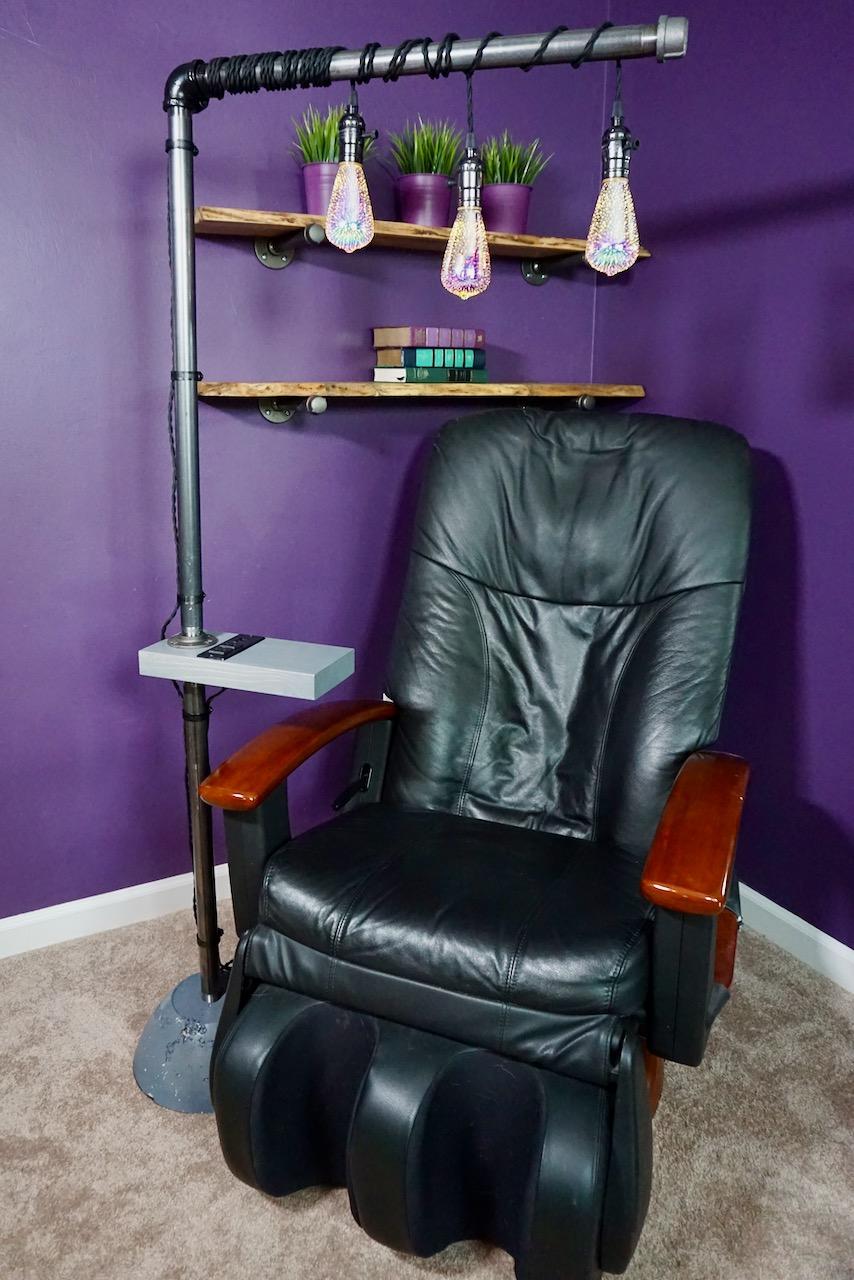

Step 7: Uses for the Base: End Tables and Lamp
We made a couple of nightstands with bases. These are stained brown.
And lastly, we used the base when we made a floor lamp with built in table.
