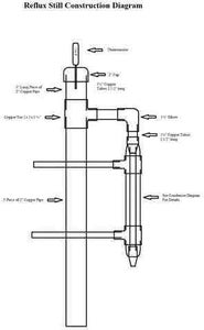

First, familiarise yourself with the diagram of the still as shown above. The column refers to where the still meets the boiler (pan), where the vapours rise. The condenser refers to the cooled pipe where the vapours collect and condense, producing high proof alcohol.

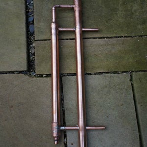

Assemble the still as shown in the photo. Cut the 15mm pipe running through the condenser so that there is 30mm of piping sticking out of the bottom of the condenser. This is also shown in the same photo.

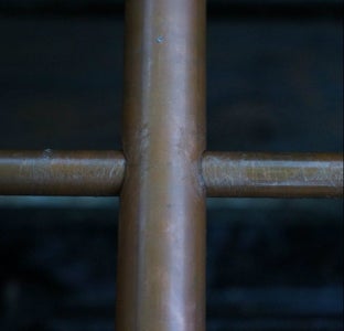

Mark a point 233mm along the column of the still. Then mark another at 466mm. These points are where the pipes will pass through the condenser.
Next, clamp the column into a vice, and drill through both sides of the pipe with the 15mm drill bit. File and sand any burrs on the edges of the holes. Sand as little as possible, as there must be a tight seal around the pipes.
Place the 150mm of 15mm pipes you cut in a previous step through the holes to ensure they fit.

Assemble the still as shown in the photo, to ensure everything fits together properly. Disassemble the still.

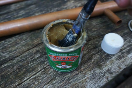

Take your chosen solvent, and rub all surfaces you previously sanded with the solvent. This will remove any grease which may affect soldering.
Then thinly coat all cleaned and sanded surfaces with fluxite, or any other non toxic flux. Reassemble the still.

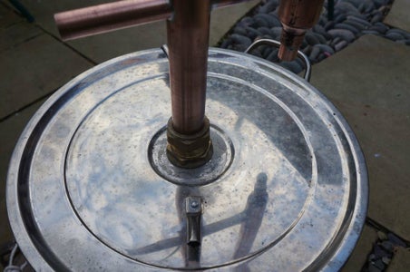

You will need to take the lid off your four gallon pan, and cut a hole big enough for the 28mm tank fitting to fit through. I would suggest drilling several holes and cutting between them with tin-snips. Place the tank fitting through the hole, and tighten the nut on either side of the lid. The lid should now look like the photo above.
Insert the bottom of the still column into the tank fitting and tighten the tank fitting.

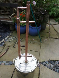

Step 11: Finished!
Your still should now be ready to use! You should perform a cleaning run before using to distill alcohol, I will link a guide to using a still below.
