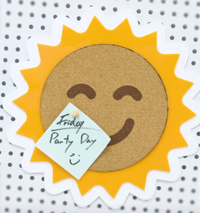

Let’s brighten up your space with the Corky Sun Memo Board—a cheerful blend of cork and acrylic that turns everyday notes into a moment of joy! Featuring a layered sunburst background made from vibrant orange and white acrylic, this memo board radiates warmth and style.
Ready to turn your reminders into sunshine? This laser-cut memo board makes it easy to stay cheerful and organized all at once.

Step 1: Place Your Acrylic and Cork for Laser Cutting
Pick cheerful, sun-inspired materials to bring your Corky Sun Memo Board to life. This design uses two layers of acrylic—white and orange—to form the glowing rays of the sun, creating a bright and playful base. At the center, a cork circle features a smiling face that’s both functional and fun. The combination of vivid acrylic and warm cork brings contrast, texture, and a little sunshine to your space.

Step 6:
When the acrylic laser cutting is complete, it’s time to bring your corky sun memo board to life. Remeber, assemble it layer by layer.
Start by gluing the light white and red pieces on the white base, making sure to align them precisely with the outline for a clean look. Next, the orange layer and the cork smile face.
assemble laser cutting corky sun memo board
