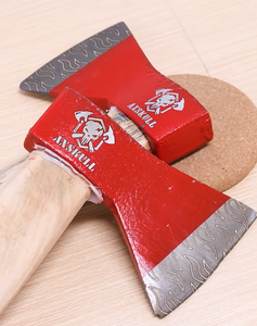

Step 1: Place the Metal Axe
Put the metal axe on the laser bed. The metal axe is well suited for laser marking.
place coated metal red axe

Once laser marking is complete, carefully open the door and get your personalized candy box. Laser marking does not produce toxic substances, and you can use the axe after a simple cleaning!
Every swing of your axe becomes a signature statement when it’s laser marked. This personalized touch not only ensures your tool stands out on busy job sites but also prevents mix-ups by clearly displaying your name or logo.
Whether you’re an outdoorsman, woodworker, or DIY enthusiast, the seamless blend of durability and style offered by laser marking transforms your axe into both a practical tool and a unique statement piece. Elevate your craft with an axe that reflects your exceptional workmanship and sets you apart from the rest!
coated metal red axe done
coated metal red axe show
