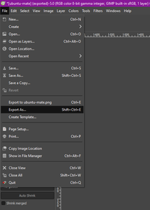

- Load you image into GIMP - you can do this by launching GIMP and selecting File > Open..., then navigating to the folder your image is in and selecting it. You should see a screen like the first image.

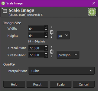

- Select Image > Scale Image... to open the Scale Image dialog box.
- Making sure the width and height are linked, set the size to be at least less than 128x64 - if you have a tall image, set it to 64. If you have a wide image, set it to 128. As long as both values are smaller than this it will work correctly
- Select File > Export As... and navigate to where you want to save the file.
- Make sure that the file extension is .png or .jpg. GIMP will automatically create the correct file type, so you can leave all the options as their defaults.
- Note the location that you saved the file, as you'll need it in the next step.

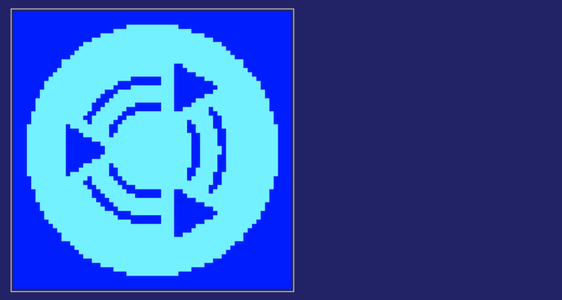

Once you have your image, you'll need to convert it into a format that your printer will understand. Doing this is very simple: all you have to do is navigate to the Marlin Bitmap Converter. On that site, simply click the Browse... button and select your image.
- Note: If you image is all one color, then you don't have enough contrast in your image. to fix this, simply re-open the image in GIMP and select Colors > Level... and adjust the input levels until you get a black and white image.
At the bottom of the page, you will see a few options. Select Marlin 2.x and choose invert, if you want your image to be inverted. Once you have the image converted, keep the browser tab open and move on the the next step.

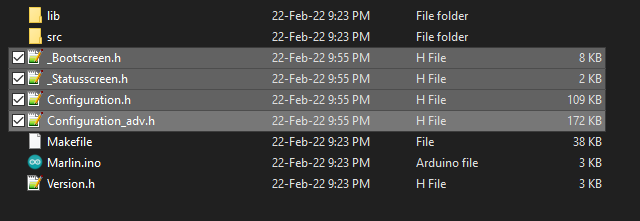

Once you download the firmware, extract it to a folder of your choice. From there, navigate into the folder you extracted it to, and open the Marlin folder. The next step is to download the correct configuration. Download and extract the latest release of the configurations, and open the folder corresponding to your printer. Since I'm using a Creality Ender 5, I'll navigate to ./config/examples/Creality/Ender-5/CrealityV1.
Next, what you need to do is to copy the *.h files into the folder that your stock firmware is in. Make sure you overwrite the stock firmware, and not make a copy.
Step 5: Adding Your Image to the Firmware

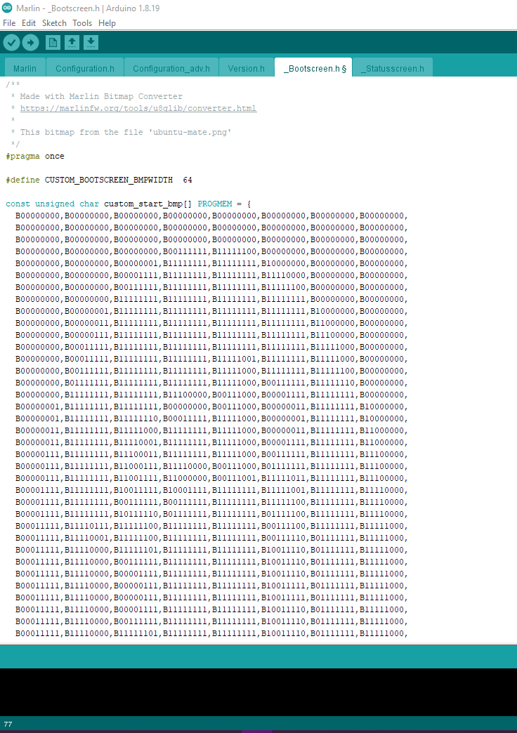

Open the Marlin.ino file in the Marlin folder of the firmware (where you placed all the configuration files). Once the Arduino IDE opens, select the tab named _Bootscreen.h. If the tab doesn't exist, then create a file call _Bootscreen.h. Open the file, and delete anything that is in the file. Copy the code that was generated on the converter website into your empty _Bootscreen.h file.

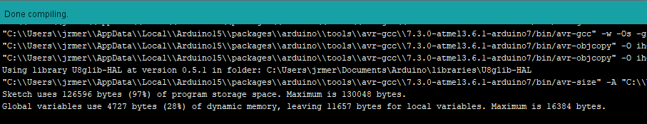

Compiling may seem like the most complicated step, but it is fairly straight-forward. All you have to do is make sure that you have the correct board and Arduino type selected. Since I'm using a Creality V1 board, I need to install a separate library that allows me to compile for my board. Look up specific details for what libraries are required for your specific printer online.
Once you have all the required libraries, simply select Sketch > Verify/Compile. (or you can press Ctrl-R). If it compiles with no errors, you are good to move on the next step. Compiling may take a while, especially on slower computers. Be prepared for it to take a while, even up to an hour on especially slow computers.

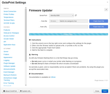

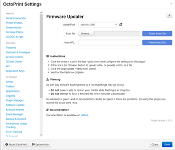

The next step is to upload your firmware to your OctoPrint setup. Navigate to OctoPrint and open the Firmware Updater plugin.
Step 9: OctoPrint - Step 2
Once you have the Firmware Updater plugin open, click Browse... next the the from file label. Browse to where you have your compiled firmware and select the file that does not include bootloader in the name. If you do upload that file, you risk irreversibly damaging your printer. The plugin will also warn you if it detects a bootloader. If you see this warning, make sure that you cancel the firmware update.
