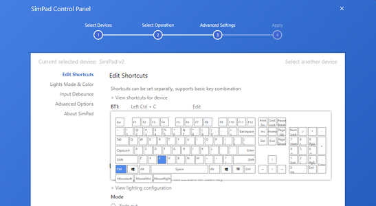

In order to do this, you first need to install the software used to program your macropad. Some may use QMK or VIA, but the one I used (and highly recommend) uses Simpad V2 software, which can be installed here. Make sure to plug in the macropad before you install the software, as you will need to connect it to the software. Once you've installed the software, you can select the macropad from the menu (it should show up as Simpad V2) and then select "Modify Shortcuts. From there, you will see a list of buttons titled BT1, BT2 and so on, as well as their current functions and options to edit their function. Once you click on the edit button, you will see the menu in the above image, which will allow you to select the keys you would press on a keyboard to perform the intended function. For example, if I wanted my keys to be able to copy and paste, I would select Control and C, as well as Control and V for the second keycap. There are other buttons, but they are not keycaps, and would thus likely be less useful to a Braille user. If you wish, you can program them similarly, but this may not be of much help. Once you've assigned the intended functions to the keys, you will have a fully functional and completed Braille macropad!
