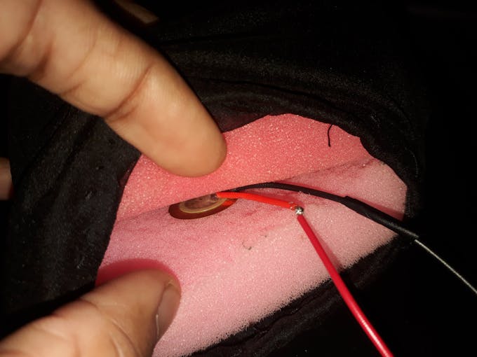

Step 3: Make an Enclosure to Cover Sponges:
Get a cloth and make a enclosure for sponges using needle and thread. I told to my mom to prepare one and she made a enclosure to cover the circuit and sponges.
Step 4: Insert Piezo Element Into the Sponge:
