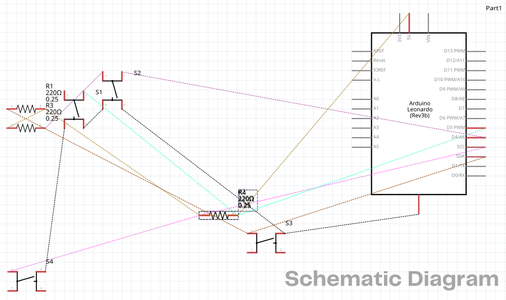

Follow through the above image of the circuit diagram & plug in your USB-C Cable to your Arduino Leonardo & your computer
