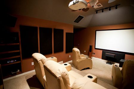

Step 5: Screen
Some home theaters contain large flat-screen televisions, but the largest TV available is 80 inches, so when you compare that to a 30’ x 70’ movie screen the TV will feel much smaller. Instead, wire a projector in the ceiling and use that to project on a screen as large as you can fit. Pros recommend a 110-120-inch screen size for a 20’ x 13’ theater room.
For the projector, you'll need an HDMI cable and a CAT5 control wire that you connect to the projector to provide an HD video feed and remote control. You can purchase a pull-down projector screen, or you can simply use projection screen paint (available at most hardware stores) and paint a screen onto any wall. Finish the job by framing the screen-painted area with a black border.

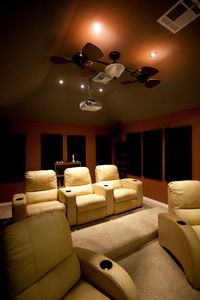

Step 7: Seating
Comfortable seating will make it more enjoyable to spend time in the theater room, so add some cozy couches or recliners. Some furniture manufacturers make theater-specific recliners with cup holders in the armrests, so this is a fun way to give a more authentic theater feel. If you decide to put in rows of seating, you might want to elevate each row to make sure those sitting in the back can see as well as those in the front.
