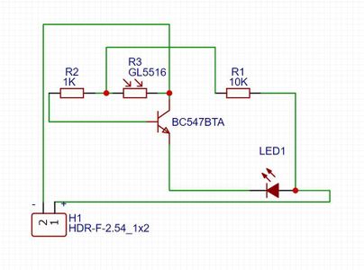

Step 3: Schematic of Dark Sensor Circuit
The schematic of dark sensor circuit along with the PCB layout can be seen above.

Step 8: Connect Resistor With Circuit
To make this circuit we are using two resistors. One is 1 KΩ and the other one is 10 KΩ. We make a parallel connection is these two resistors. In this way, we got three terminals. One is common terminal and the other two terminals is empty terminal.
We connect this common terminal with one empty leg of LDR and the empty terminal of 1 KΩ resistor with Base leg of transistor. Then connect 10 KΩ resistor empty terminal with positive terminal of power source.
Step 9: Connect LDR With Circuit
Now we need to connect LDR with the circuit. We connect LDR one terminal with collector leg of transistor and the other leg is connected with common leg of two resistors.
Step 10: Connect LED With Circuit
To make this automatic light circuit, we are using 3v (5mm) LED light. Connect this LED light positive leg with positive terminal of power supply and connect LED light negative leg with Emitter leg of transistor.
