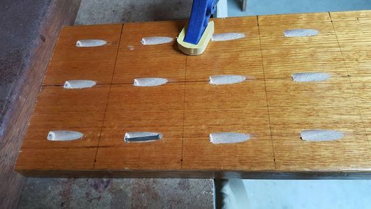

To keep my project cheap, I recycled an old drawer front. Not sure what the wood was but looked good when sanded down. I cut the wood to the size I wanted and shaped the top corners for a better look. I started by marking out the sections on the wood. I divided the length of wood into two and drew a line, which is my first hole point. Then divided each side by 2 to get the center points for the two remaining holes. Repeat this as many times as your board allows. I have a gap of 7 cm between the start of the first hole and the start of the second hole going up the board,
Step 3: Adding the Holes
I clamped the jig to line up with the center line and drilled a hole into the board. Repeat this for all the holes and add as many rows as you want on your board. Make sure not to go to far up the top so that the darts pop over the top. I found the holes did not go deep enough for the darts to sit in snugly. So I used a thick nail and hammer at first to make the holes deeper. Then got a bit smarter and used the drill to make then a little deeper.
