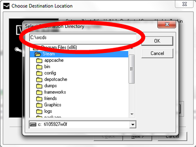

Step 1: Download and Install the Half-Life Dedicated Source Update Tool.
Download the Half-Life Dedicated Source Update Tool here then run the program.
When installing change the destination folder to "C:\srcds" by clicking the "browse" button and then at the top of the window that says "Select Destination Directory" change whatever is in the top bar you can edit to "C:\srcds (If the file does not exist the installer will make the folder for you).
