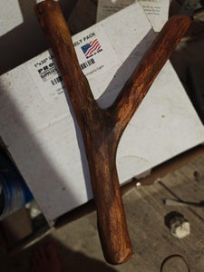

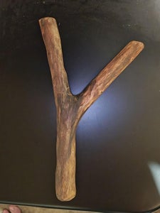

  1. One symmetrical "Y"-shaped tree limb, the size is up to you, I recommend aiming for one slightly larger than you want the finished project to be. Make sure you get one that's not rotten or brittle!

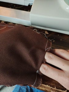

Step 6: Sew Together
Turn the outside of the bag inside-in.
With right sides together, put the outside of the bag into the inside. Make sure to line up your seams! Pin it in place with a couple of pins.
Now sew around the mouth of the bag, but leave a small gap, as pictured.
Step 7: Turn Your Bag Right Side Out
Pull the bag all the way through to turn everything right side out.

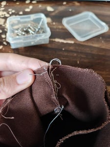

Step 8: Sew Around the Very Top
Fold the edges of the gap down and in to match the rest of the seam. Sew around the mouth of the bag again, keeping very close to the edge.

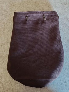

Step 9: Create a Channel for the Ties
Find the small gaps you left on the outside of your bag. Sew two more lines around, the same width as your gaps, one above and one below.
Step 10: Optional: Cut Holes to Weave the Ties Through (for Aesthetic Purposes Only)
If you want to see a little more of your ties for decorative sake, you can add four more holes (two on each side, at 1/3 and 2/3 of the way across, which is at 2 inches and 4 inches on my bag of 6 inches total across), as pictured.
Do not cut through both layers! Only the top/outside layer.

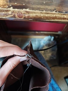

Step 11: Finish Your Openings
Go ahead and just finish the tie openings for a clean look, and to keep your fabric from fraying away. The process for this is the same as finishing a button hole by hand. I used embroidery floss which worked well, and is much quicker than sewing thread.
If you opted to add the four extra holes, you'll have six total to finish, while if you chose to skip Step 10, you'll just have the two.

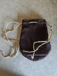

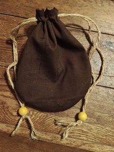

Step 12: Thread/Weave Your Ties Through the Channel and Holes
Decide what length you want the ties to be. You need two pieces of cord (or whatever you choose to use). Again, be generous at first- you can always cut a bit off, but you can't easily tack more back on.
Now thread the cord through as illustrated. If you've got a crochet hook, you'll find they make this part much easier. If you don't, no worries, just work with it until you manage to thread it all the way through.
Step 13: Finishing Up the Seed Bag
Almost done!
Just add your beads on the end of your ties, and mark or embroider the Hylian glyphs on the front.
Congratulations! You've completed your Deku Seed bag.

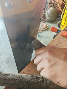

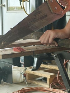

Step 15: Trimming Your Limb Down to Size
You'll notice that the limb I've chosen is way too big. I start by trimming off the enormous excess from the bottom part. If this is also the case for you, then go ahead and do that now.
Next, I need to do the same thing on the top, but it's a little trickier since I have to keep both "arms" of the slingshot even.
Get yourself a ruler or similar straight edge to use as a guide for where to make the cuts. Make sure both sides are even.
Since every limb is different, one size isn't going to fit all, but you need the arms to be an estimated 4 inches at least- for this slingshot the arms are around 5 inches.
Check your work after big cuts to make sure it's even, and cut a bit more if you need to. Just remember, you can always take a little off, but you can't tack it back on, so be careful.

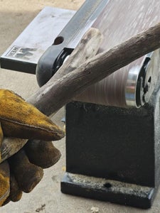

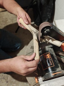

Step 16: Grinding Off the Bark and Shaping Your Slingshot
Your hunk of wood should really start to take shape by now, but there's still a little way to go.
Here's where you can decide to use rasps and files to scrape the skin off, or a belt grinder. It's up to you, though one is obviously faster (and more dangerous- be careful).
If there are any ugly knots on your slingshot, now is the time to grind them away. Hold the handle to test the feel- if it needs shaping do so now.

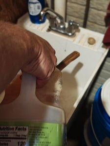

Step 18: Oil the Wood
Make sure your wood is quite dry before you begin. Some of you will prefer buying proper wood oil, but, as I can attest, plain ol' cooking oil will suffice too.
You need to apply a coat of oil, and work it into the wood thoroughly. Allow it to soak in for a bit, then wipe away the excess oil and make sure your slingshot is clean. You may now either move on to the next step or add a couple more coats as you see fit.

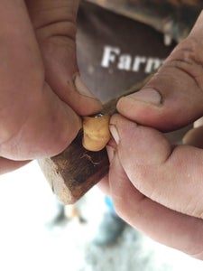

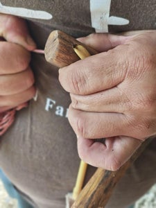

Step 20: Attaching the Band

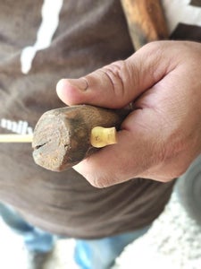

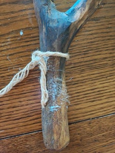

Start this step by drilling holes in both arms just barely big enough to squeeze the band through. The holes must NOT be big enough for your steel bbs to fit through.
Thread a bit of string or twine throught the hole in your arm; loop this around the band and back through the hole as pictured.
Pull the strap of the band through the hole.
Secure it by inserting one of your steel bbs into the surgical tube. Make sure it's all the way in to create a strong anchor.
Repeat this with the other arm (make sure you don't twist your band in the process).

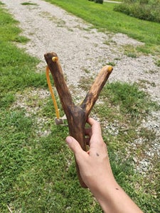

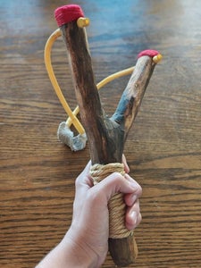

Step 21: Finishing Touches!
Your slingshot looks pretty good! But let's make it look great.

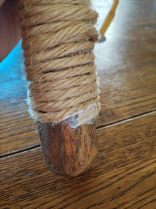

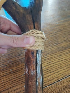

Wrap the handle with your cord of choice- secure the end of your cord around the handle with a knot and some glue. Wind it around tight and even for a clean look, applying a little glue as you go to ensure security.
Finish off by glueing the end of the cord firmly to the handle.

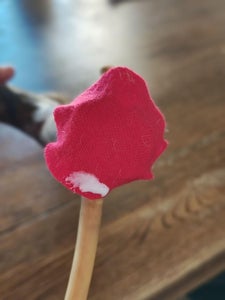

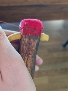

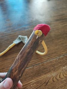

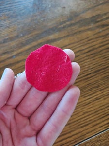

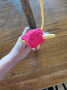

Now cut out some circles to fit neatly over the tips of the arms, not too big, not too small.
Apply just a little glue to help keep the beginning of your thread in place. Attach your red thread with a simple knot, and start winding as illustrated. Make sure your fabric is fixed smoothly over the tips, I found it easier to start below the fabric and wind up over it.
End with a tiny knot, and a bit of glue if needed.
Step 22: The End

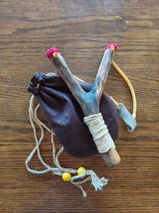

It's dangerous to go alone! Take your brand new Fairy Slingshot and Deku Seed Bag!
Bonus points if you paint yourself some smooth, round rocks to stock your bullet bag.
