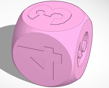

Introduction: How to Make a Dice in Tinkercad? Easy & Fast & Simple
I made a dice on tinkercad, and the reason that I did this is that my friends and I always play games that require dice, having this made by myself, we don't need to purchase the dice.

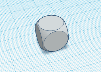

Step 1:

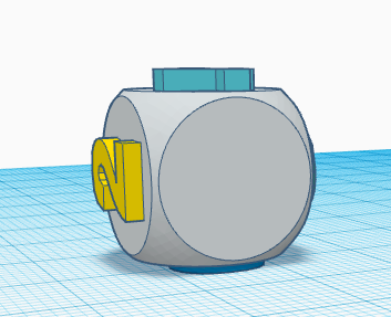

  1. drag a blank die shape under 'basic shapes'
  2. drag a blank die outlined in orange.
Step 2:

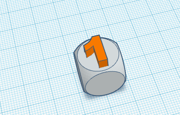

  1. you may need to change your shapes filter to 'design starters' to locate numbers
  2. drag #1 shape to the workplace.
  3. adjust the number's size.
  4. Adjust the number's position(use the function align)
Step 3:
  1. Let's repeat previous steps to place the other number on the other sides of the die.

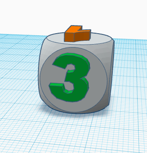

Step 4:
  1. Let's repeat previous steps to place #3 on the other side of the die.
  2. Don't forget to align and group so you can easily drag and adjust the shape of the die.
Step 5:
  1. Let's repeat previous steps to place #4 on the other side of the die.
Step 6:
  1. Let's repeat previous steps to place #5 on the other side of the die.

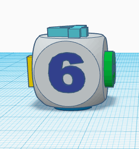

Step 7:
  1. Don't forget to rotate the die and switch to the blank side.
  2. Let's repeat previous steps to place #6 on the other side of the die.

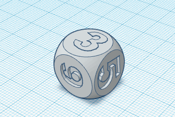

Step 8:
  1. Select all the numbers and make them be holes.
  2. Select all to group them.
Step 9:
  1. You can choose the colors and fonts based on your preference.
