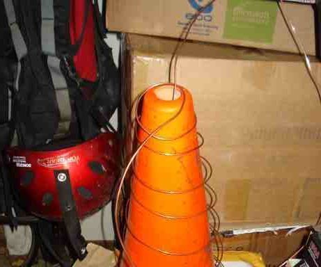

For my first "Fox Hunt" to detect a transmitter of a known frequency, I just used a modified procedure noted in "Handie-Talkie Tricks" and seen in the photo that consists of a powdered milk can with a 325 stainless steel screen cut to fit inside the lid, some shop towels to pad the radio that was placed in with the antenna removed. At first I just used the walkie-talkie against my chest method until I was closer. When I was close to the transmitter, like maybe 20-30 yards from, I set the antenna to the third harmonic since I was using a cheap Baofeng UV-82 that isn't a superheterodyne radio. The Baofeng's are an SDR technically with auto-gain settings that are noted in the homingin.com article regarding "Offset Attenuator". If you want to be able to fit the RTL-SDR or other SDR detection system into a can, then this type of system can be made using an ASUS Tinker Board or other microcomputer instead of using a laptop. You can also use a portable spectrum analyzer like the tinySA that is an under $50 device.

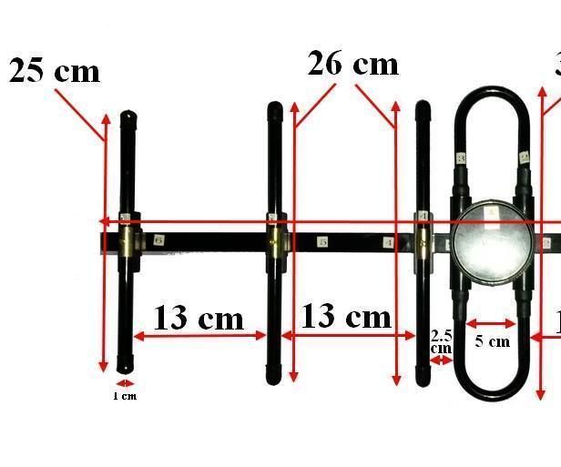

Next for RDF, I started working on a portable telescopic yagi with folding elements that is a modified tape measure system described in the May 2007 QST article "Adapting a Three Element tape Measure Beam for Power Line Noise Hunting". As seen in the photo, I need to finish designing the adjustable hairpin matching component and the balun, then assemble. I plan to mark the tuned lengths with colored scribed lines so I can adjust to frequencies of interest quicker in the field.
