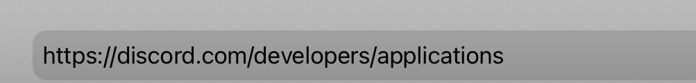

Step 1: Discord Developers Portal
We are going to go to discord developers portal.

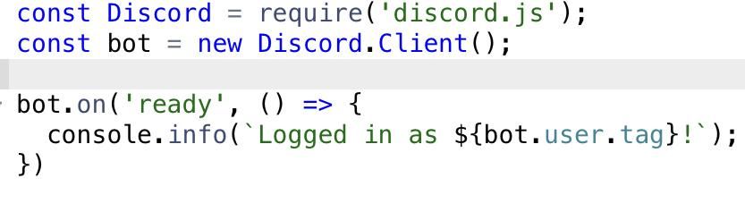

Step 7: Coding
We are going to start coding and with importing discord.js and saying that discord client = const bot. Then we are going to write that if bot goes online on a log tab we are going to see that it goes online. Code below
require('dotenv').config();
const Discord = require('discord.js'); const bot = new Discord.Client();
bot.on('ready', () => { console.info(`Logged in as ${bot.user.tag}!`); })

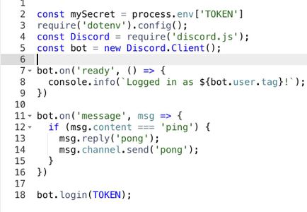

Step 8: Finishing the Code
We are going to write that if from new Discord client we receive massage “ping” it responds with “pong” And we are adding .env file that nobody sees in this file we have bot token (don’t show your token to anyone) to copy this token go to discord developers portal to bot tab than copy your token and go to replit.com and on left you can see lock picture press it and it opens a tab with your .env things add a new env called “TOKEN” (don’t rename it or script won’t work) and paste you token to token equal to (token) Then scroll down and press insert button. Code below
const TOKEN = process.env.TOKEN;
bot.on('message', msg => { if (msg.content === 'ping') { msg.reply('pong'); msg.channel.send('pong'); } })
bot.login(TOKEN);

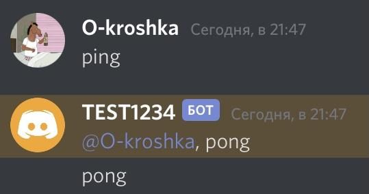

Step 10: Trying the Command
Try saying ping and your bot is going to reply with pong in 1 second.
