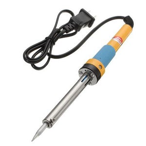

First you need to install MissionPlanner and QGround control on your computer. These are 2 very necessary programs to program the Pixhawk 4 and write parameters on it. You don't really need many tools but some scissors and a soldering iron. You MUST make a clean area to put all your parts down and work on the drone. Numerous times I have lost parts or not have a pair of scissors because my work area wasn't organized and clean. And I strongly recommend to buy all the parts before you start building. It makes it so much easier to actually make a drone. It makes a month long project into a day.

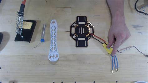

First, I recommend to velcro your power distribution board in the direct center. I personally put it directly under where I put my Pixhawk 4 due to having a lack of room. As you can see in the image you need to solder your ESC's directly onto the positive and negative contacts on the power distribution board. Make sure not to solder directly on the battery terminals,because that is where you'll be soldering the male fitting of your drone battery cable on to connect the female fitting thats on the battery.

Unless you got a power disribution board with a built in flight computer and ESC's(Which I wish I had done) You're going to need a ESC for each motor. Now what are ESC's. Electronic Speed Controllers? ESC's are a circuit composed of tiny electronic components. ESCs connect to an RC model’s electronic system such as the Pixhawk 4 in order to control an electric motor’s speed and thus the speed of a drone. Well now that you know a tiny bit abot them you know that they're necessary in order to fly a drone because they control the speed at which the drone motors spin. Now with drone ESC's you have to solder the positive and negative wire to the power distribution board. Now the 3 wired hanging off of the ESC's, you need to plug into the PX4. You need to plug the wires into the numbers on the PX4 thats 1-8 not 1-6. The 1-8 is for motors while the 1-6 is for like servos and additional things you might want to add onto your drone.

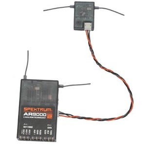

This was the most difficult part I had in the creation of my drone and I don't know if I'm doing it 100 percent right but it works. Anyways, I put a PPM encoder on the RC port next to where you plug in the motors. And then I got the 8 wires handing from my PPM encoder and plugged it into a Spektrum AR6210. Then I plugged in my Spektrum satellite receiver into the side of my AR6210 and it worked.

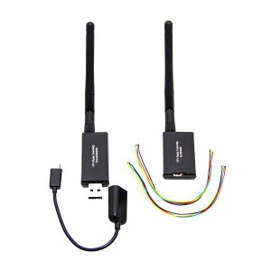

The telemetry system must be plugged into the telemetry port one, because the second port is not turned on. In order to turn the second port on though just follow these instructions in this link https://bit.ly/3qWo5KC As you can tell I used Bitly to shorten the URL.
