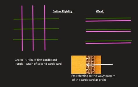

A technique often used in woodworking is crisscrossing the wood grain which combines the tensile strength along the parallel grain and the sturdiness along the perpendicular grain to form a strong structure as a whole. The same layer by layer method will be used when making this case and the grain of each layer of cardboard will be perpendicular to the previous layer
  1. Stick the paper template parallel to the grain of the cardboard, as shown in the image using cello-tape on all four sides of the paper template

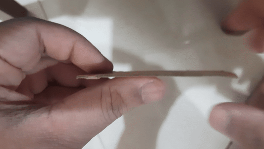

  1. Firstly, carefully pull apart the paper from the cardboard, as shown in the images above
  2. Cut it into thin strips, a little more than the width of your case
  3. Add glue along perimeter of the main plate , one edge at a time.
  4. Once you have added the glue to an edge, making sure the strip is straight and there aren't any wrinkles, hold it down on the table for about 1-2 minutes.
  5. Repeat this for all four sides and cut of the excess, only when you are sure it is dry!!

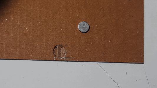

  3. Find a nice space where you want the magnet to be, and cut a hole into the side of the main plate as shown in the Third Image.
  4. Now push the metal strip into the hole that you have created , don't rush this step!!! If it doesn't fit make sure you use a knife to make enough space.
  5. Then put a small dab of super glue to ensure that the metal strip is never coming out lol.
  6. Finally, place a magnet over the region where you placed the metal strip to ensure the magnet actually sticks!
Lid
  1. Once again using the Main plate as an outline to cut out a rectangular piece of cardboard for the lid. (Sixth Image)
  2. Now keeping the magnet in place on the main plate place the lid on top to get a rough measurement of where the hole for the magnet has to be cut, lengthwise.( Seventh Image)
  3. Then leave about 2mm space(widthwise) from the edge of the cardboard and trace out the magnet on the lid. (Eighth image).
  4. Cut the circle that you have made making sure to cut only a layer of paper and the corrugated layer of the cardboard.
  5. Now put a dab of super glue in the hole and place the magnet inside it.
  6. For a final check, ensure the magnet on the lid is perfectly aligned with the metal strip on the main plate.

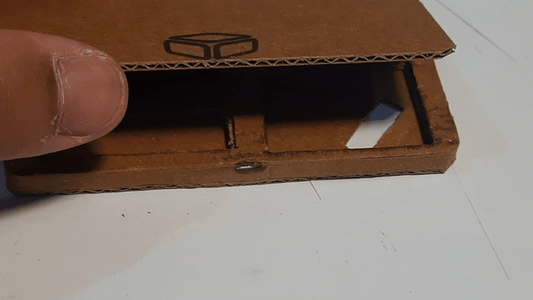

Step 7: Final Part: Making the Hinge
TOOLS: Xacto Knife, Fevicol
We're almost there!
  1. Take a piece of cardboard that is 5cm by 5cm and peel of the paper layer ( First Image)
  2. Now placing the lid over the main plate (magnetically attached) stick the paper about 1cm from the edge using fevicol.
  3. Once thats dried, add fevicol to the side of the main plate. (Third Image)
  4. Finally cut off the excess, the excess should look something like the Fourth image.
As the hinge dries make sure to move it once in a while so that it doesn't stiffen too much making it difficult to open the lid.
