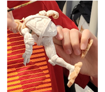

Step 4: Anatomy and Body
Once you have the wire posed, you can start adding Super Sculpey original clay to the skeleton. I started building a leg by shaping the clay into a general form, then added muscle definition using my shaping tools. You can add muscle by adding clay bits or carving it away. Having the reference images will be a huge help when adding detail. Using a blade at this step is one of the most useful tools. You can cut small slivers of clay off the figurine to get fine detail. If you are happy with the sculpted body section and detail (ie. leg) and are ready to move on, bake the clay in the oven per the package directions or at 270 Fahrenheit for 10-15 minutes. Repeat steps above to sculpt each body section (i.e. torso, arms, etc) and bake per above as each section is completed.

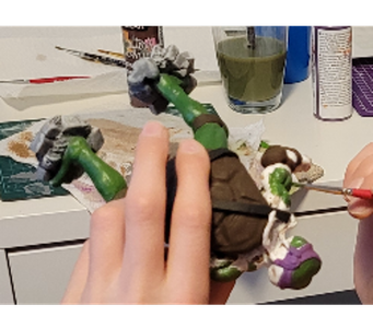

Step 8: Optional: Painting
I painted the ninja turtle sculpted figurine to ensure my colours matched my reference image. I painted a base colour for each section (i.e. green for body, brown for shell). Then added details by layering colours and using a variety of brush sizes.
Painting is optional because if you are using coloured clay, you might not need to paint unless you want a lot more detail. There are plenty of painting tutorials and videos on Youtube that can teach you different techniques.
