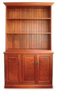

When building a piece of furniture you normally go to your timber rack or timber agent, select what you need, and get into it. With this job the customer supplied the timber, but I got a surprise when I saw its quality. I have rarely seen red cedar with this kind of figure.
The customer harvested the cedar on his property and had it milled some time later. Rather than wasting time (another budget job!) travelling to his shed some way out of town, I gave him a materials list and asked him to bring the wood in. He left it outside my workshop with a ‘mudmap’ and some measurements of what he wanted.

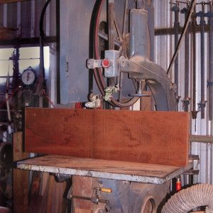

Delay between felling and milling meant some boards had long cracks in the ends. I cut these out and rejoined the boards without losing evenness of grain. The boards were all 40mm thick so I had to sharpen my old bandsaw and rip 25mm boards to get my 20–21mm thick stock for the sides, blades, shelving and doors.
Splitting was not a problem but dressing was. The very tight and curly figure kept lifting out the grain. Changing the angle of the planer cutter might have helped but experimenting costs time, so I surfaced one side and thicknessed the boards through my drum sander. It worked fine and I ended up with a full 20mm thickness.

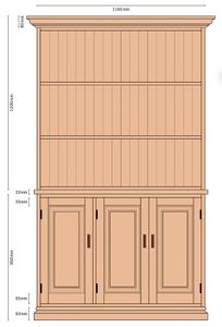

The mudmap called for the sides of the top to be 400mm deep and the sides of the base to be 600mm deep. I considered that to be a little overkill but wouldn’t have questioned it except that the rejoined boards were 530mm wide and adding 70mm would have spoiled the figure on the base. We decided on a 500mm deep base and a 330mm deep top.

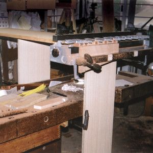

The back edges of the sides were rebated 20mm deep to accept the back panel. The 6–7mm lip left on the side is given a full round. (When I was an apprentice I was taught that the back should be as good as the front – I was obedient in those days.) I then sanded the insides of the sides on the stroke sander with a 240 grit belt for a fine finish. Doing this before cutting the dovetails gets the shoulder up nice and tight and avoids destroying the fit with a careless stroke later.
With my Leigh dovetail jig the base was dovetailed ready for assembly. I have an old aluminium body Black and Decker 1hp router permanently set up for dovetailing. This router is one of four that I picked up some years ago—having them set up ready to go for different tasks saves a lot of time.

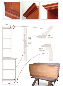

I moulded the top edge of the skirting (fig. 1) and glued it together. Fitting a shaped bracket at the inside back corners prevents the bookcase getting damaged if someone slides it sideways.

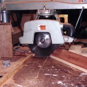

The moulding was made from ex 100 x 25mm cedar on the spindle moulder (fig. 2). I cut the mitres on my docking saw using a home-made mitre board held in place with F-clamps. This is a lot quicker than setting up a sliding compound saw.

The three cedar doors have 55mm wide x 22mm thick stiles and top rails and 75mm x 22mm bottom rails. Their joinery is made with typical rail and stile cutters on the spindle moulder.
At the very start of this job I put aside the best timber for the panels. By splitting these from one piece I got three really nice bookmatched pieces that stand out strongly against the fairly plain bookshelf section.
The doors hang on 65mm (2 1/2”) brass hinges and are held closed with magnetic catches fitted at the top of the doors. The handles were supplied by my client.

After removing the backs, shelves, doors and hardware I went over the piece with a fine-tooth comb checking for anything that could offend. I applied two coats of sanding sealer, sanding back heavily to fill the grain. This was followed by three coats of pre-catalysed lacquer. I don’t put this on too thick as people today seem to want to see and feel and the wood.
