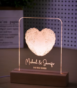

Laser engraving on clear acrylic brings intimacy, precision, and a soft glow to this beautifully customized Fingerprint Love Lamp. With two fingerprints forming a heart and names delicately engraved below, this piece turns a simple light into a heartfelt expression of connection and commitment.

Laser engraving on transparent acrylic transforms this Fingerprint Love Lamp into a glowing celebration of connection. With two fingerprints forming a heart and names delicately engraved below, every detail is captured with precision and care—making each lamp truly one of a kind.
