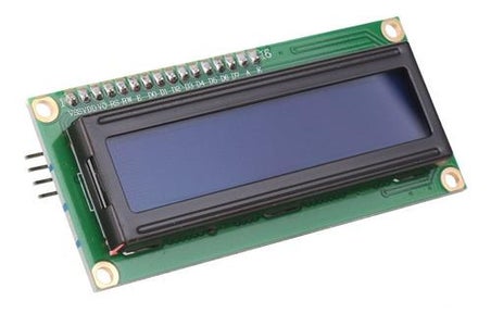

  • 1 - LCD 16x2 with I2C Module [Text screen]

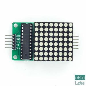

  • 1 - 8x8 LED Matrix with MAX7219 Module [Secondary screen]

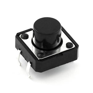

  • 4 - Push button [Buttons]

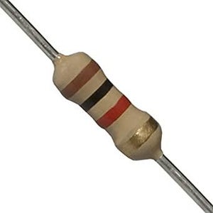

  • 5 - Resistance (1kΩ) [For pull-down push buttons and TFT connection]

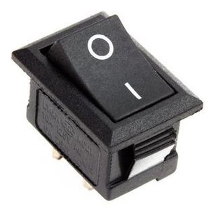

  • 2 - Switch [ON/OFF and sound control]

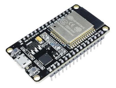

  • 1 - ESP WROOM 32 Devkit [Microcontroller]

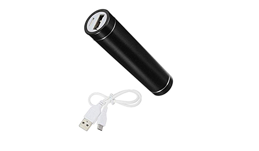

  • 1 - Power Bank (5V) [Battery]

  • 1 - Usb-MicroUsb wire [Connecting the battery to the microcontroller]

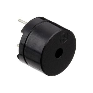

  • 1 - Passive buzzer [Sound effects]

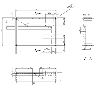

In this step, we are going to draw the shape of each piece of the case, including the space where electronic components will fit. It is also a good practice to draw the pieces together showing how they are connected. For sketches, we don't have to size the pieces, but both the proportions and the needed standard components are determined at this stage.
Step 4: Croquis
Here, we are going to size the pieces of the case keeping the proportions we used in the sketches. The difference between croquis and sketches is that croquis are in 2D and their purpose is to show the measures, which are not included in sketches. Croquis have their own rules and we have to respect them. In this case, they are the IRAM rules (Argentina).

At this point, we only have one step before building the case for the functional prototype, and it is making the manufacturing plans. On this purpose, we may do it in Onshape from the pieces we have already modeled (respecting their corresponding rules). These plans may be useful for building each piece for the final case.

Now it is the moment of making the case where we will be able to play. First we are going to cut te space for the screens using the jig saw. After that, we stick the other 3 pieces with glue and let it dry. Then we are going to cut the space for the hinges, and screw both of them with the nuts. Finally, we have to do the hole for the buzzer to fit in using the drill, and the ones where the switches fit under pressure with the jig saw.

After we have the case done, we have to fit the components in it. In order to do this, we are going to use the anchors we have from the previous steps. The screens and the joystick will be bolted. Here we use the gimlet to make the place for the screw. Before screwing the joystick, I had put an EVA foam slice below to protect it. For the ESP32, I have screwed it to EVA foam and a piece of wood that remained from before to avoid an overheat, and then stuck it to the case with foam double-sided tape. With this same tape I've stuck the power bank and the PCB, giving it some space for the pins from the wires. I anchored the buzzer using the hot glue gun and stuck the push buttons to the top with glue. Finally, I have made 2 holes for the wires from the joystick and the buttons.
