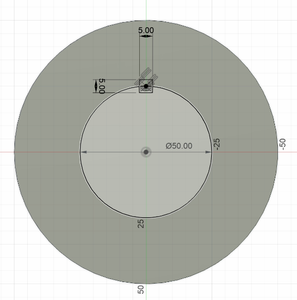

Step 2: Adding the Inner Circle and Keyway
After you are done extruding your gear we will start doing an inner circle. Click “create sketch” and choose the circle you just made. Choose “Centre Diameter Circle” , place it directly in the middle and make the second circle which should be smaller than the first one. Then click at "create" button again and choose “Center Diameter Rectangle” and place it on the outer line of inner circle(check the photo), it will be our keyway*. When you've placed it choose the dimensions for it, when you are done with choosing the dimensions of one side click tab and choose the dimensions of the other side.
*Keyway - The main purpose of said keyways is to prevent components from slipping on and rotating independently from the shaft they're mounted on, which adds torque capacity in driven systems.

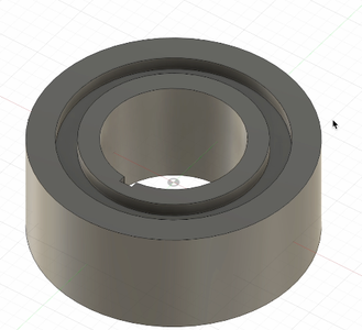

Step 4: Creating Additional Circles
Click “create sketch” and choose “Centre Diameter Circle” and draw two more circles around the inner circle which are smaller than the outer circle. When you are done drawing you click “extrude” and push it inside our gear a little bit depending on how thick your gear is.
Step 5: Mirroring the Feature
Now we need to mirror the side and click the “Create” button. Be careful it is not the “Create Sketch” button we scroll down to the end and choose “Mirror”. In the pop up we instead of “bodies” we choose "features” after that we select the last circle that we did, which we extruded . Then we click on the "mirror plane" and choose the yellow side inside(watch video carefully at 1:04 to understand). Now that we are done with the body it is time to do the teeth.
