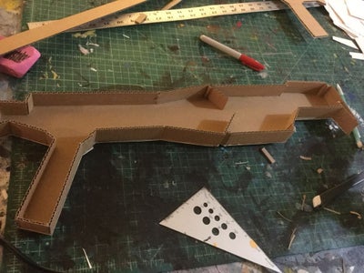

1. Cut off the wings, undercarriage, and the gun barrels from your paper template and set aside (pic 1)

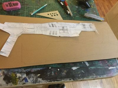

2. Transfer the paper template to cardboard (pic 2)
3. Cut out two versions of the cardboard base (pic 3)
4. Cover opposite sides of the cardboard panels with comic cardboard (pic 4)
5. I cut several strips that were the width of my yardstick (pic 5)
6. I used these strips to create the boarders for my base (pic 6 - 7)
7. I also use the strips to create support within the inside of the gun (pic 8)
8. Cover both sides and all edges of your gun with comic cardboard (pic 9-11)

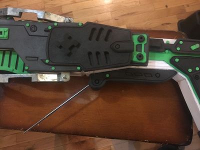

3. Use your exacto knife and cut your details into the foam. Use your heat gun to accentuate those lines. Look to picture for detailed explanation (pic 3)
4. Glue entire side plate onto the actual gun base (pic 4)
5. Glue grate on top of side plate. I also glued a craft foam rectangle around front grate (pic 5 + 6)
