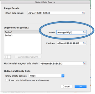

Now we will make a meaningful legend that will allow us to identify what each line on the chart corresponds to. When Excel puts in a legend, it marks the first column as “Series 1” and the second column as “Series 2,” as can be seen at the bottom of the chart. The first column contains the average high temperatures, so we need to replace “Series 1” with “Average High.” To do this, click on the legend. Then click on “Series 1.” This will put a box around it. Right click “Series 1” and click “Select Data.” This will open a new window.
Step 11: Edit the Name for "Series 1"
In the window that we opened in the previous step, there is a textbox titled “Name.” In that textbox, type in a meaningful title (e.g., Average High).

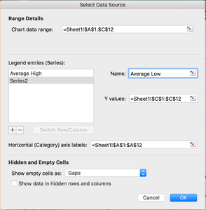

On the left-hand side of the window, there is a selection window, titled “Legend entries (Series).” Click on “Series 2” in that window.
Step 13: Change the Name for "Series 2"
As in Step 11, type a meaningful name. As explained previously, Excel placed what was entered in the second column into series 2. Since what was entered in the second column was the average low temperatures, we should name this “Average Low.” Once you enter the name, click “OK” at the bottom of the window.
