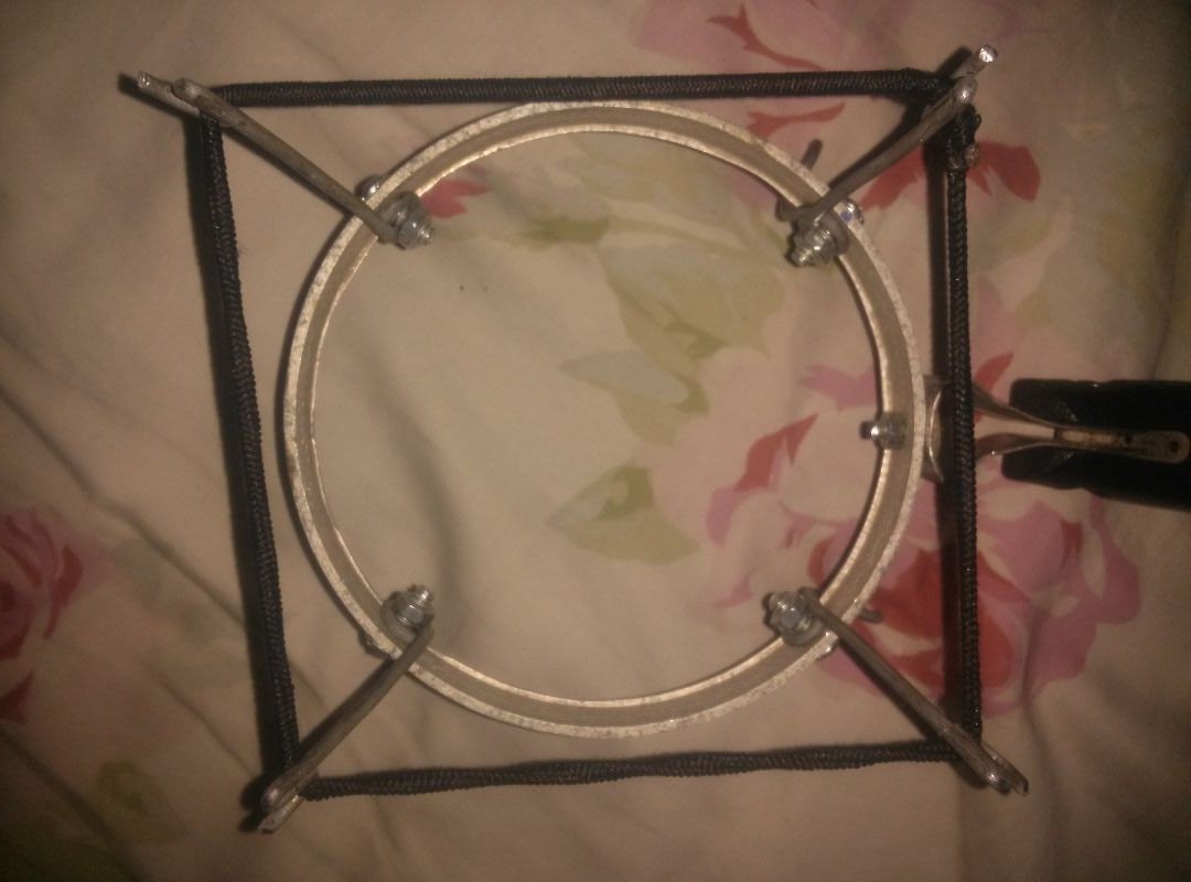

Step 1: Make / Get a Ring
Get a ring (strong) or make one out of anything with a big diameter such as from pvc pipe.. I got one from junk yard made of aluminum.
Step 2: Make Holes
Make four holes in the ring in cross....
Step 3: Steel Wires
Using steel wires , make the exact shape...i made it about 5 cm from the center circle to the end.
Step 4: Attachments
Attach these four steel wires with the ring using nut and bollts.
Step 5: Make / Get Another Ring With a Small Diameter
Step 6: Make Holes
Make 4 more holes in the ring with smaller diameter in cross.
Step 7: Making Steel Bent Strips
Using this steel roll , cut a strip of about 4 cm. Make a hole into the center of it. Bend it from the sides as shown. I also made them round. You can do it without making it round.
Step 8: Attaching Steel Strips
Attach the strips by nut and bolts.
Step 9: Attaching a Microphone Holder Clip to the Smaller Diameter.
To attach your microphone into the spider shock mount you have to attach a holder clip to the smaller diameter with a curled / bended steel strip as shown in the figure.
