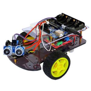

In this Instructable today, you will be shown how to make a Obstacle Avoiding Robot with a few cheap parts and a free open-source software coding platform IDE called Arduino. This is a great robotics project and is very easy to make. After you are finished, you can let it free and see what it can do!

- 1 Chassis https://goo.gl/HLWwsd --This is not required but is helpful. it gives you motors and wheels and a place to build your robot. If you don't buy this, it's OK and all you have to do is make your own chassis out of cardboard. If you do buy chassis, then you don't need the 2 motors --

Now it's time to connect these parts you have collected and make this robot. Refer to my schematic for all the connections.
--For the motors, the orientation in which you place them will make a difference so plug them in and if after finishing, it doesn't go forward, try switching them.--
The ultrasonic sensor needs to spin with the servo motor so you either need to buy a ultrasonic bracket or use 2 pieces of cardboard to make one.
The 9V battery going to the L298N H-Bridge needs to be a 4 AA Battery Holder unless you can get the 9V battery to have 2 separate wires.
