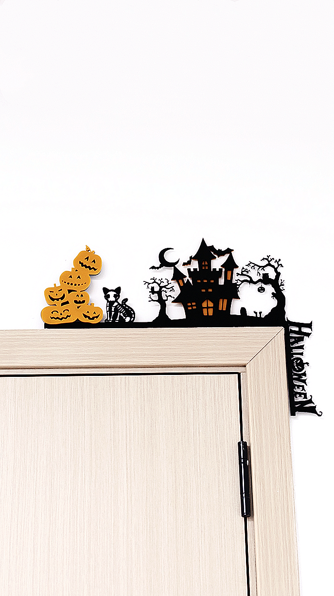

Step back and admire your finished Halloween acrylic decoration! The sharp lines of acrylic make your design pop, giving your door frame a unique, festive look.
My Halloween door frame is glowing with bats and pumpkins — what about yours? Try making one with your own twist: maybe add ghosts, witches, or even your family name in spooky letters. I’m sure you can come up with a design even scarier (and cooler) than mine!
A well laser-cut halloween door decor made with thunder bolt
