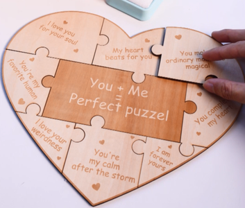

Celebrate love and creativity with this unique heart-shaped puzzle. Using a laser cutter, each piece of the puzzle can be engraved with sweet messages, creating a meaningful and personal gift. Whether for Valentine’s Day, anniversaries, or simply to show someone you care, this project is simple, fun, and deeply heartfelt.

Step 1: Place Wood on the Laser Bed
Select a wood sheet suitable for laser cutting (e.g., 3–6 mm plywood). Place it flat on the laser bed. Secure it with pins or clamps so it doesn’t shift during cutting.
plywood on laser bed
Step 2: Open the File and Check the Settings
Import the wooden chess design in Lasermaker and check if your material is large enough. Double-check everything, and decide if you want to add or subtract elements according to your preferences. For the laser cutting layers, pay extra attention to the power setting.
parameters for laser cutting a heart shape puzzle
Step 3: Focus Your Laser Machine
Proper focusing is essential for achieving crisp engravings and smooth cuts. If your machine supports auto focus, a single click will set the correct distance for flat wooden boards. If you prefer manual focus, use the focus stick to adjust the laser head until it just touches the surface of the wood at a perfect vertical angle. Spending an extra moment on accurate focusing will pay off with professional-looking results.
bolt auto focus
Step 4: Frame the Design and Start Laser Cutting
Use the software’s “Frame” function to outline the engraving and cutting area. Make sure the projected frame matches your wood sheet.
Frame your design
Step 5: Monitor the Laser Cutting Process
Stay close to the machine while it’s running and watch the cutting and engraving progress. Keep an eye out for excessive smoke, small flame-ups, or any movement of the material that could affect the outcome. Make sure your workspace is well-ventilated, and rely on air assist if available to achieve cleaner edges on the wood.
laser cutting the puzzle
Step 6: Complete the Task
Once the laser job is complete, carefully remove the heart-shaped puzzle from the bed. Inspect each piece and gently remove any wood residue. Your puzzle is now ready to be shared or gifted! Bring your love to life piece by piece! Try making your own heart-shaped puzzle and fill it with personal messages for someone special. It’s a simple way to create a heartfelt, laser-crafted gift that shows thought, care, and creativity. Your loved one will treasure every piece—and every word.
