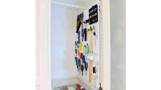

In my old craft room I had several walls of pegboard tool storage. Unfortunately my craft room is much smaller now and I don’t have accessible wall space to hang pegboards.
So we did what any upcycler would do and came up with a compromise. We cut this pegboard down so we could mount it vertically onto slow close drawer slides. As you see above in the 2nd pic, the drawer glides are attached to the pegboard. Then, as we’ll explain further ahead, the pegboard is attached to spacers and finally the cabinet. No wall space needed like in my old craft room!
But before we hang the pegboard we have to cut it to size and paint it! We use a circular saw to cut it to fit the Pax cabinet. In order to fit above a glass shelf, we cut the pegboard 33″ high by 22″ wide.
Also cut a riser to lift the bottom of the pegboard when it’s installed so that the pegboard will clear the door hinges. Ours is 1-7/8″ high by 2-” long to fit our Pax cabinet configuration, but your’s may be different depending on the kind of cabinet you’re starting with and how it’s accessorized. You can read more here about the Ikea Pax Planner and how to install the Ikea Pax System.

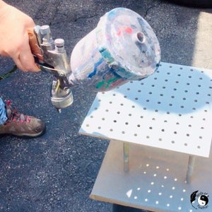

You can either spray or roll the paint. For this project, we’re using a roller for the primer.
First, pour primer into a paint tray. Then roll on a coat of primer and let it dry. However, all rollers are not created equal. Because the nap gives a smooth paint finish, our favourite roller is a Bennet mini roller. Of course, you can use a full sized roller too; we're just using what we have!
Once dry, we give the primer a scuff sand with fine grit sandpaper and remove the dust again. Then we paint the pegboard white using PPG BreakThrough. While working on another pegboard project, I recently learned how to paint using a spray gun. As a matter of fact, this DIY jewelry display which features pegboard, was my first paint sprayer project!

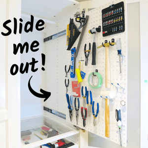

Step 4: Mount Drawer Glides
The drawer glides we’re using are soft close full extension, 22″ in length and rated for 100 lbs. Because they need to be mounted separately, separate the drawer slides into the inner and outer parts first. To do that, press the yellow button you see in the first pic, and the inner member will slide right out.
In the 2nd pic you can see the separated pieces: inner member on the left and the outer member on the right. The inner member gets attached to the furring strip on the pegboard, while the outer member gets attached to the spacer.
In the 3rd pic, with the pegboard already hung, you can see how the inner member of the drawer slide is attached to the furring strip on the back with the screws provided.
You could actually mount the inner member directly to the pegboard using Chicago screws without the need of a furring strip, but that would require drilling new holes in both the pegboard and the metal drawer glide (which we’ll show you in an upcoming Instructable).
Again, when you attach the inner members to the top and bottom of the pegboard, you must ensure that they are parallel to one another. Once those are attached, it’s time to mount the outer members of the drawer glide to the spacers.

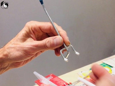

Pegitz
For traditional metal peg hooks, Pegitz are silicone bumpers that fit into pegboard holes. The pegboard hook then slides into the Pegitz and provides a slip-free lock to hold the peg. Pegitz are removable in case you want to move tools around on the pegboard. At the time of this writing, they come in a pack of 50 for around $18 (with tax) Canadian. They are a little pricey so if you are watching your pennies, there are other cheaper options below.
Electrical Tubing
Raid your electrical supplies for shrink wrap tubing. Use a piece that’s just slightly bigger than the peg prong. Slip the heat shrink tubing around each prong of the peg hook. Cut to size. Then wave a lighter around each piece until the tubing has shrunk to fit tightly around the prong. This takes mere seconds, as you'll see on the video.
This method works pretty well. To make it even sturdier, shrink wrap it twice as we’re showing above in the third pic. In all honesty, I do prefer the Pegitz because the hook does not move at all. However, there’s no denying that it’s more economical and also fun to play with fire (but be safe and do this over non combustable materials)!

Step 10: Make It Move!
Once you’re done arranging your tools on the pegboard, you can slide it back into the cabinet.
When you close the door, you’ll no longer see the visual clutter. Moreover, the pegboard organizes your most used tools – all within reach!
