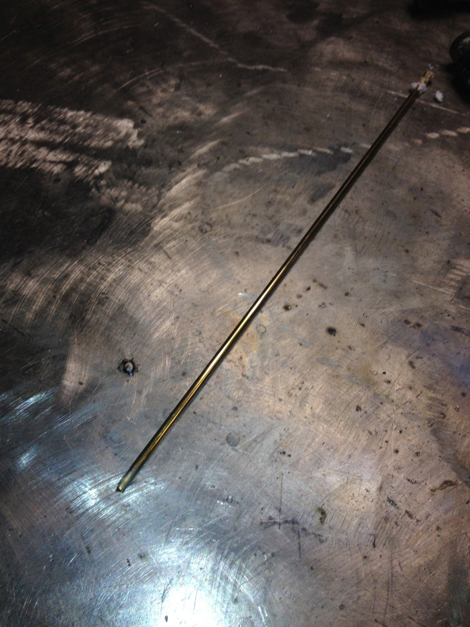

You can remove the cap (the part which the firing pin compresses, causing the powder to burn), if you would like to have a clearance hole; by pressing a pin or other suitably slim item down the pin hole, you can clean the tobacco plugs from the cutter. Keep in mind that the later brazing step may ("will most likely") interfere with the clearance hole. :-)
Stand off the cartridge from a hard flat surface by using a washer or machine nut which has a hole LARGER in diameter than the cap.
Find a very slim tool; a punch, a jewelers screwdriver, allen wrench, etc... Place it down the open end of the cartridge and into the little hole in the bottom.
Now, using a small hammer (or other suitable stand-in for one) tap the punch gently...the cap should pop right out.

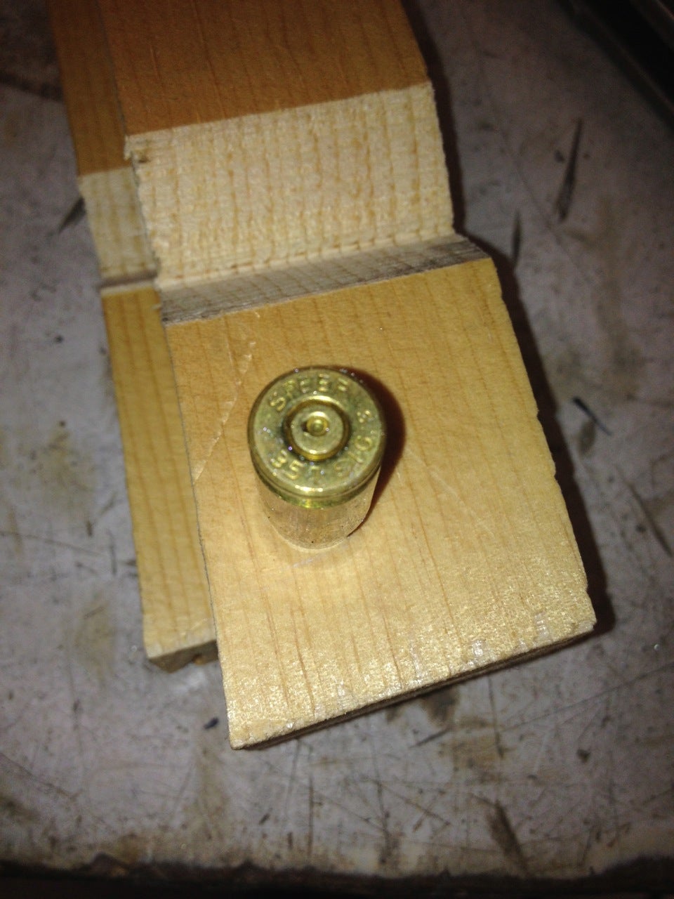

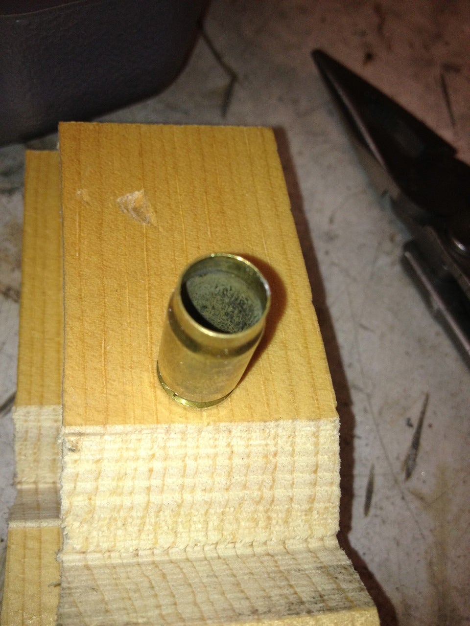

Place the cartridge in a vice with VERY SOFT jaws....it is very thin brass after all :-)
I made a quick little V-grove holder for the vise, from some scrap wood in the TechShop Woodshop.
Using a suitable tool, sharpen the INSIDE EDGE (Interior diameter) of the cartridge very carefully. I used a dremel tool with a very fine lapping tool installed. A small rats tail file or even a sharp knife, will work quite well.

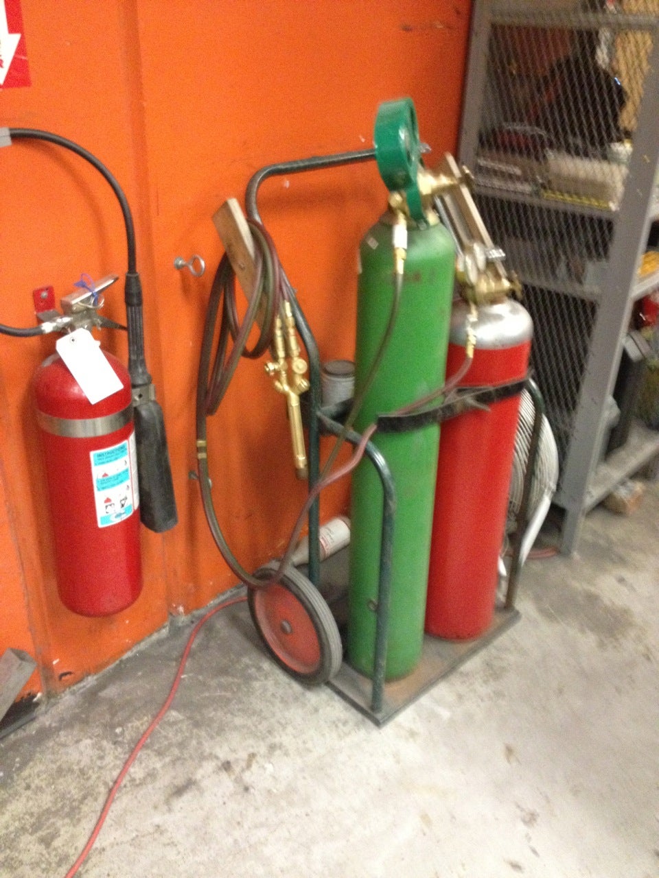

Using a very small brazing tip, preferably 000 (Triple "ought"), in my case it was double-ought, and using appropriate work hold mechanisms, place the handle on top of the cartridge and braze it on...Go easy, that is a LOT of heat and thin brass!
Do NOT forget to use flux when using the Oxy-Acetylene torch. The prep time, in this case, was several minutes....for a braze time of a few seconds :-)
When done, allow to cool and then head into the dirty room (grinders, chop-saws, sand blasting) to clean up the finished product!

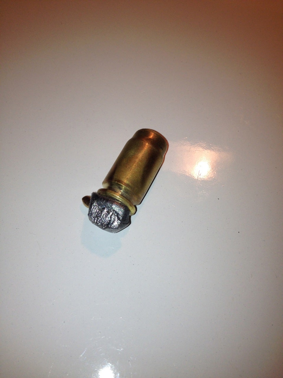

Hopefully, if you choose to use a penny for the handle......you will use an OLD one..not one of the new aluminum ones like I did!
Aluminum melts easily.

Note that I melted my handle waaaaay tooooo much with the acetylene torch...so I ground it down and contoured it to fit.
