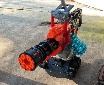

These will change slightly based on the type of nerf gun you get, but not by much. So long as you pick a nerf gun that can fire multiple shots one after another before needing to reload, we'll just be communicating with a servo to make that happen.
If the nerf gun only requires pushing down the trigger, that's easy enough. We just need to mount the servo such that when it rotates a certain amount it pushes down the trigger and either hold it down or repeat the process based on how the nerf gun works. Mine was a bit more complicated, and required the trigger to be held down to allow for rapid fire, and then a mechanism on top needed pulled back and forth. This is still able to be accomplished with just a servo (though mine needed a more powerful one).
This is the nerf gun I used, but I honestly would recommend looking for a different one for your project. It's big, which is fun, but even that aspect was a bit tricky because it really weighs down the tank robot. The bigger issue, though, is it requires a lot of force to pull back the triggering mechanism far enough to actually fire.
Step 2: The Nerf Gun Is.... Fully Operational
Mount the servo motor on top of the tank, in a position that allows the Nerf gun parts to still move correctly. This can be done by using screws or a 3D printed mount. Make sure that the servo is secured in place and that the arm of the servo is connected to the trigger of the Nerf gun. Once the servo and Nerf gun are mounted, test the rotation of the servo by connecting it to a power source and making sure that the Nerf gun can rotate to different angles. If you don't have 3D printer or access to a 3D printing service, you can use alternatives methods like using adhesives, clamps, or even hot glue to fix the servo and nerf gun in place. As you may have noticed if you watched the video at the start, this is a just for fun project and I want the servo back at the end of it so I just used duct tape. It may be a little silly looking, but it works!
If your gun has the same kind of mechanism mine does, you may need to get a bit creative. I tend to go overboard when it comes to repurposing things and ended up using a pole and a socket cover (actually), but the idea can be using in a much more normal way. The idea is just that the pole needs to be able to push and pull the mechanism, but would be resting up against different parts of it so we can't just adhere them together. As such, having something for the pole to move within like the socket cover made it so that the pole could move up and down due to the angle while still pushing and pulling effectively. To accomplish this without such an odd-looking combination, you could use something like a thinner pole (like a tent stake) and a circular metal piece like a decent-sized washer.

The same microcontroller (in this case a Romeo BLE) will control both the tank robot and fire the nerf turret. I modified the example HuskyLens code that is set to have a robot follow the object it's tracking such that the nerf turret will open fire whenever it sees the target (sometimes it will move to look for the target but won't see the target at that moment).
If your robot isn't already assembled, begin by putting together the Tank Devastator according to the instructions provided in the package. It's, thankfully, pretty painless. Be sure to get the code uploaded to your microcontroller before you put the top piece of the tank on, though!
The HuskyLens comes with an attachment that can be used to adhere it to the Devastator, but I used mine to put it on the front instead of the top so that there'd be room for the nerf gun. This will likely work well for your solution as well, since the top of the tank is the most intuitive place to house the nerf gun.
Lastly put the nerf gun on top and connect everything together! The code assumes that the servo is connected to pin 2.
