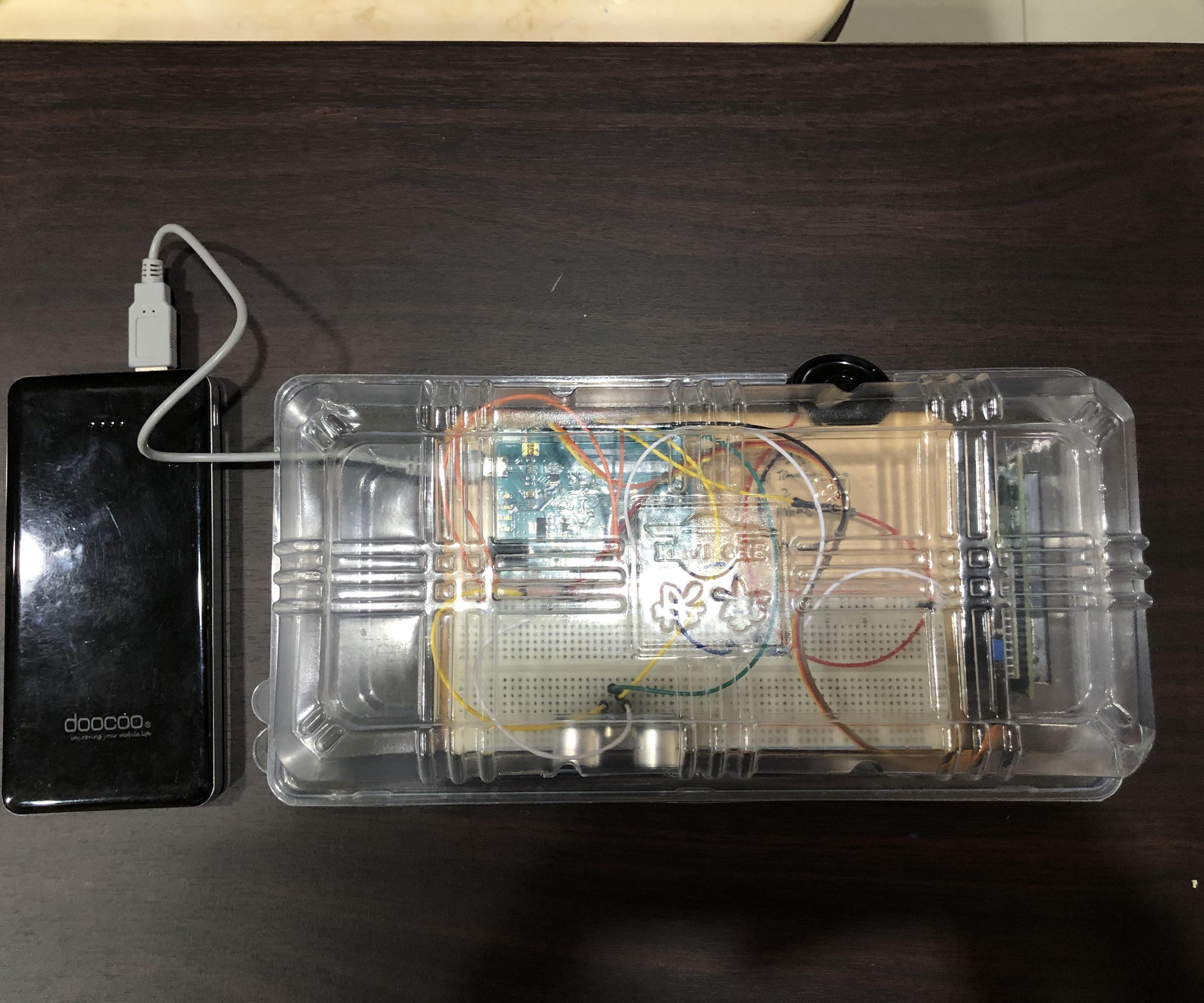

Step 1: Connecting the Wires
Just follow the following picture, and you won't go wrong
Which is the
Red left LED to D11 Red right LED to D8
Yellow left LED to D10 Yellow right LED to D7
Green left LED to D9 Green right LED to D6
The shorter end of the LED connects to the resistor. The resistor will be connected to the negative end of the breadboard.
